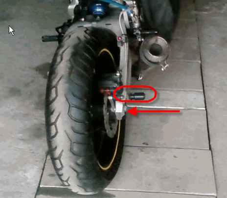

i still used the old forks but i upgraded its braking system...
Brembo Brake Master Cylinder with Titax Brake Levers, and Goodridge Brake Lines
Brembo Floating Disc Calipers, Brembo Sinthered Brake Pads and Galfer Wave Rotors
Brembo Rear Brake Master Cylinder with HEL Braided Brake Lines
Galfer Wave Rotors with EBC Sinthered Brake Pads

garyboy_palaboy wrote:.
Photos of cool stuff...
I like the rear sets and rear stand crash bobbins, what make are they and where can I get some :up:
http://cgi.ebay.com/ebaymotors/ws/eBayI ... 709wt_1193
