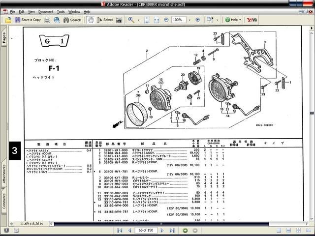

is the nc30 headlight fits nc29 ? anyone?
refers to the microfiches, both headlights using a different code/part number.

Re: nc30 Cowling on nc29 ?
Post by binge »
IIRC the actual head lamps are the same. But the mounting brackets are different.
I think the NC30 headlamps are further apart.
Post by leopard_pagan »
and slightly bigger in diameter.
bought a set of NC30 headlight covers having been told the same. i had to file them down a good 1/2cm to even fit the NC29
Post by zul_cbr »
leopard_pagan wrote:and slightly bigger in diameter.
so, u have fitted ur nc29 with nc20 headlight.
sis, do u have a picture of it ?
what's ur comment?
thanks in advance. ;)
btw, this is from the microfiches.
NC29
NC30
