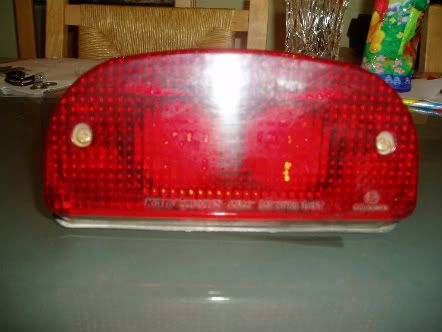

Thought id post a few pictures of my rear light.

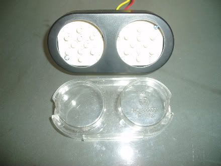

uses a motrax led light that cost about £20
Remve the clear plastic lens

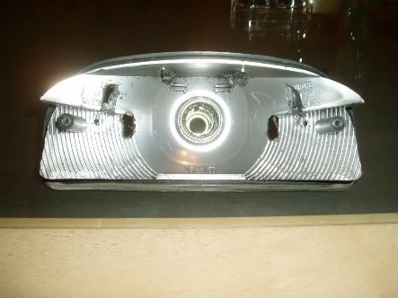

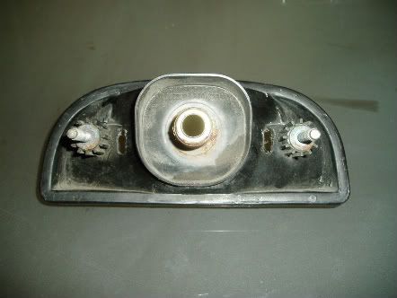

Remove original wires,bit of work with the Dremil & drill two holes
Fit led light

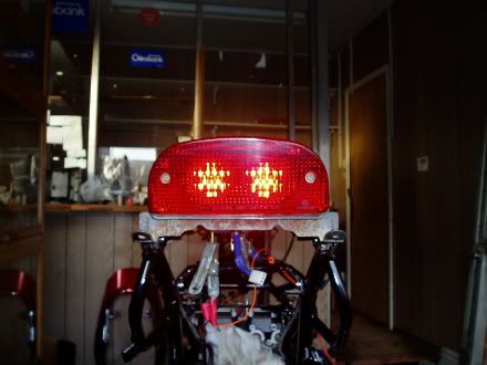

Refit original lens (just fits)
Light back on the bike
This stops the chance of riding at night with no rear light due to one buld blowing.

you have to butcher the original light if you look at picture 3 and compare it to your own rear light you will see the bits i ground out, you also rip the original wiring out and thread the motrax wires through the original hole, i have wired these into the scrap original wiring so i can use the connector on the original wiring loom, it only fits by removing the clear lense of the motrax light but then gives a perfect fit.

Looks good,Does brake light still work too?

It all works and being led will use less wattage and last for ever.
