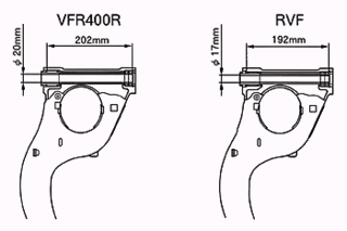

Jon
Posts: 165
Joined: Tue May 20, 2008 2:00 am
Location: Brisbane
Re: vfr single sided swingarm on a nc23
Post by Jon »
NC30 and NC35 swingarms are different, not sure which will be closer to the NC23 dimensions.
The shock is offset to the left on both of them to give exhaust clearances
jon.

jolley1982
Posts: 27
Joined: Mon Dec 29, 2008 10:10 pm
Location: widnes
Post by jolley1982 »
cheers for then diagrams jon i will try to measure mine to see which is closest
