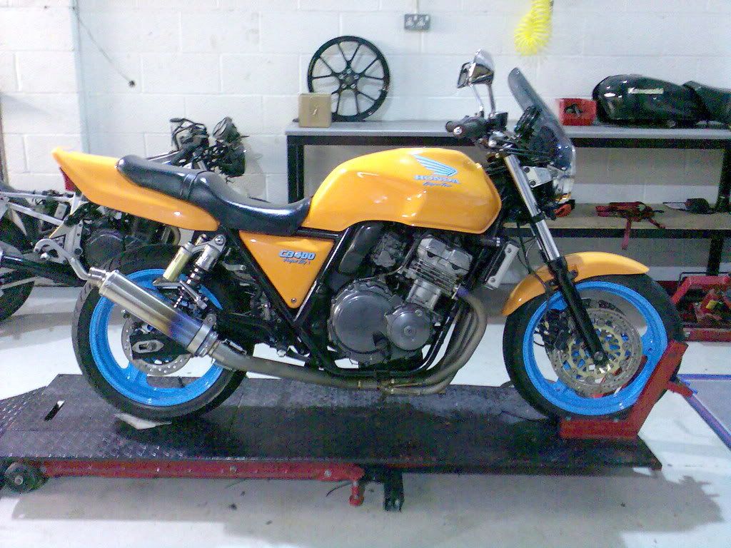

it all started to go wrong when i sourced a full one off titanium system for her bike after that i could not help myself tinkering with it to make it just how she wanted it
her bike is nearly done just want to get some pazzo style levers and a nice set of bars + the seat is going to get a makeover

those wheels are definatly a center point for the bike , well matched with the tank decal. exhaust system does look ace though.
