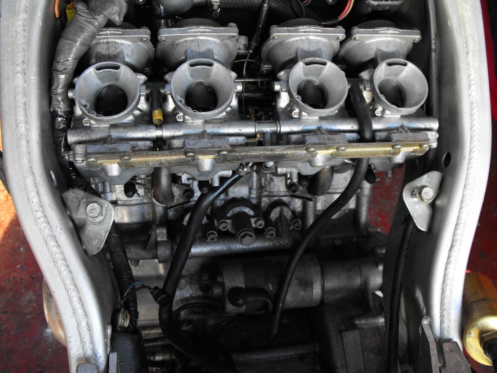

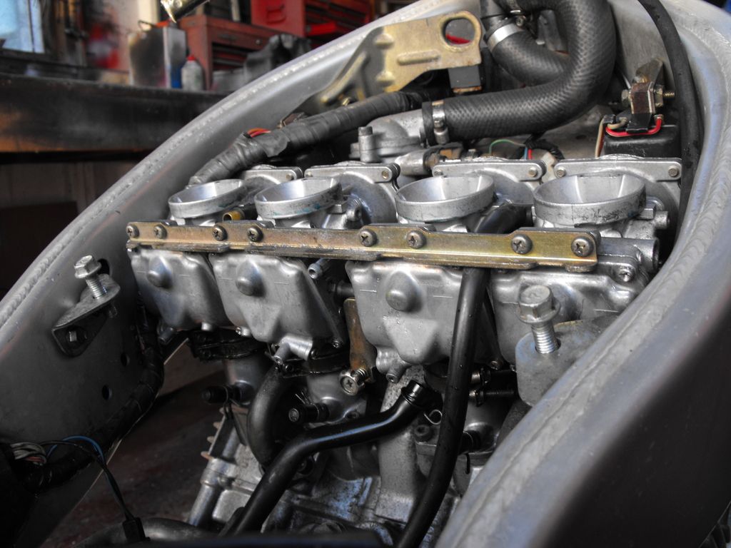

Getting some new airbox rubbers as mine are solid. Just wondering what model carbs i have. There is no return cable on the carbs and no place for one.
The reason i ask is the bike is a bit of a mix of models and i hear the rubbers can be different??

SP 2TK carbs have metal tops as yours appear to have and no return cable.
The earlier Genesis has the return cable.
The later 3EN2 has plastic tops.
I have no input on 3EN1 carbs.
These are 2TK;
The Genesis airbox rubbers fit and are readily available at reasonable cost.
These are 2TK;

thanks thats exactly what i needed to know!
They look identical to yours.
Any recommendations on where to purchase the rubbers?
