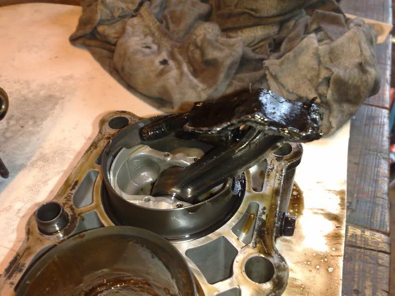

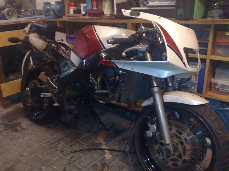

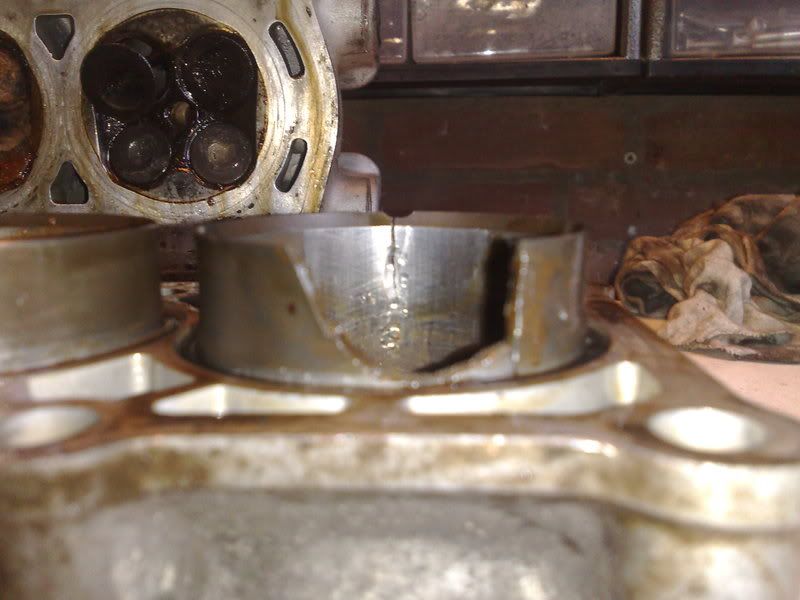

Got myself a new project yesterday. Picked her up for 50 pounds.
I think you can see why she was so cheap. Time to start looking for a good 400RR engine or a 600R engine.

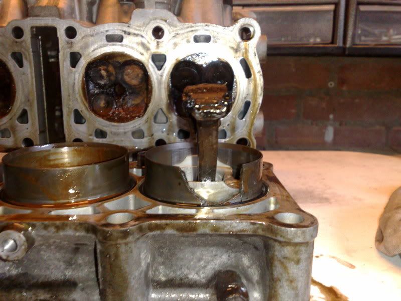

Nah, bottom end is completly knackerd. It acctually cracked the crank. The inlet cam is also bent and cracked. Was quite a blow. Haven't had time to inspect the gearbox/clutch yet but judging by the amount of s**t that was thrown through the engine i'd be suprised if they survived the ordeal unharmed.
