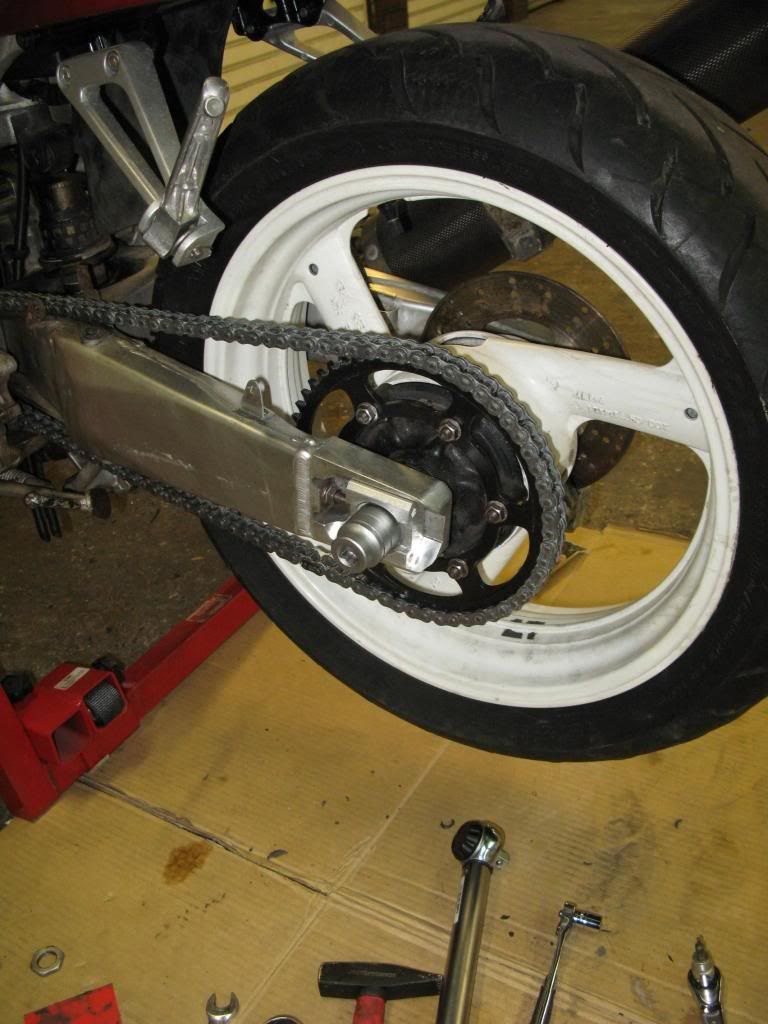

Does anybody know anything about fitting a R6 swing arm into a FZR400 1WG Gen. Or any other swing arm to use a 17" wheel.

The R6 has a stacked gearbox so the swingarm is longer without affecting the overall wheelbase. Best to use the basic Yamaha r back end from TRX ThunderCat etc

i have been down your route and live were ther are no fzr's espicially 3tj's.....please take my advise and find a 3tj. im using 17x5.5 on the rear and retains all stock geometry. i would not buld a fzr without a 3tj swinger in the rear. it also happens to look great, puttin a r6 swinger on ther will make it ride like pooh. and is way easier to put a 3tj on. just need to make a sleeve for the pivot axle. if your in europe its easy to find one and cheap. same price as r6. good luck on your ride bro.

The 3en2 is a deltabox arm, similar to the 3tj. The width is a little narrower on some of them, for the cost you might as well go with the 3tj back end.

It's the 17" rear wheel that's the benefit; not the arm itself.
The wheelbase is only altered slightly and it's better suited.
There are a couple of 3TJ arms up for auction at present at a reasonable price which is a rarity in itself.
(infact be quick; I might buy them to add to my "central stores" cache) :grin:
Make sure you get the seal guard (chain protector) if you go down this route; they are NLA.

so the idea would then be to fit the 3TJ swinger with the R6 (red spring) rear shock and a 17"in rim on the rear :grin:
the only other idea iv been given was using the GSXR600 SRAD swinger needs %mm removed to fit and the account for 10mm sprocket offset then run the matching GSXR rim with a 180 tyre?

Whats the 3jt swing arm look like? Been thinking about same thing with mine. Thx
