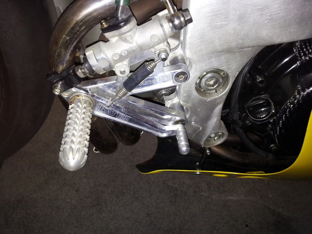

I am building a race bike, and have a set of battle rearsets (score). never seen anything so chunky.
Question is, I am chasing spare parts for them (i.e. shifter/brake pedals/pegs) does anyone know where i can get them??
I have scoured the net and all I can find is same for a cbr600... which does not help much..

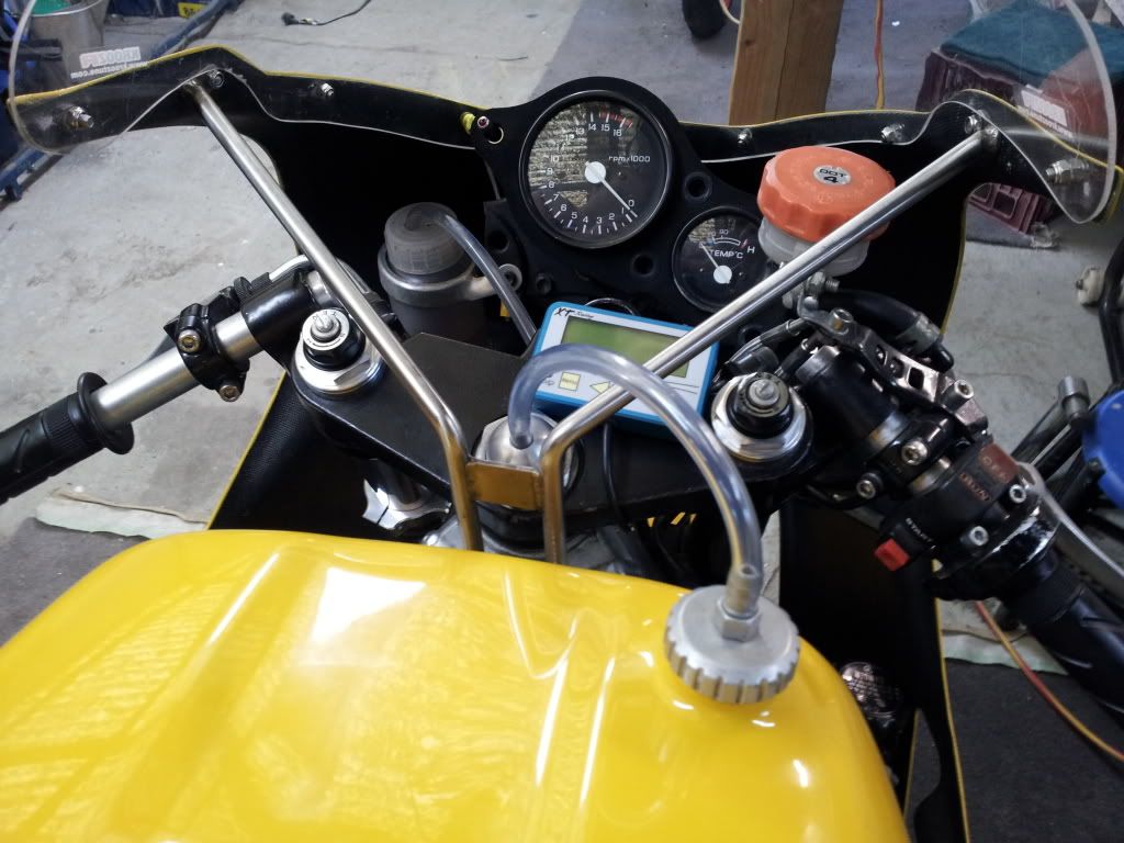

pics:
and some more pics, cause i know people love em!!

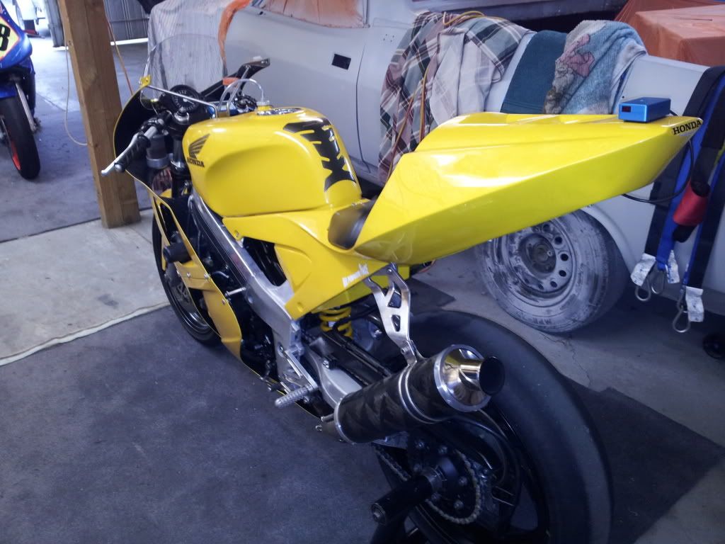

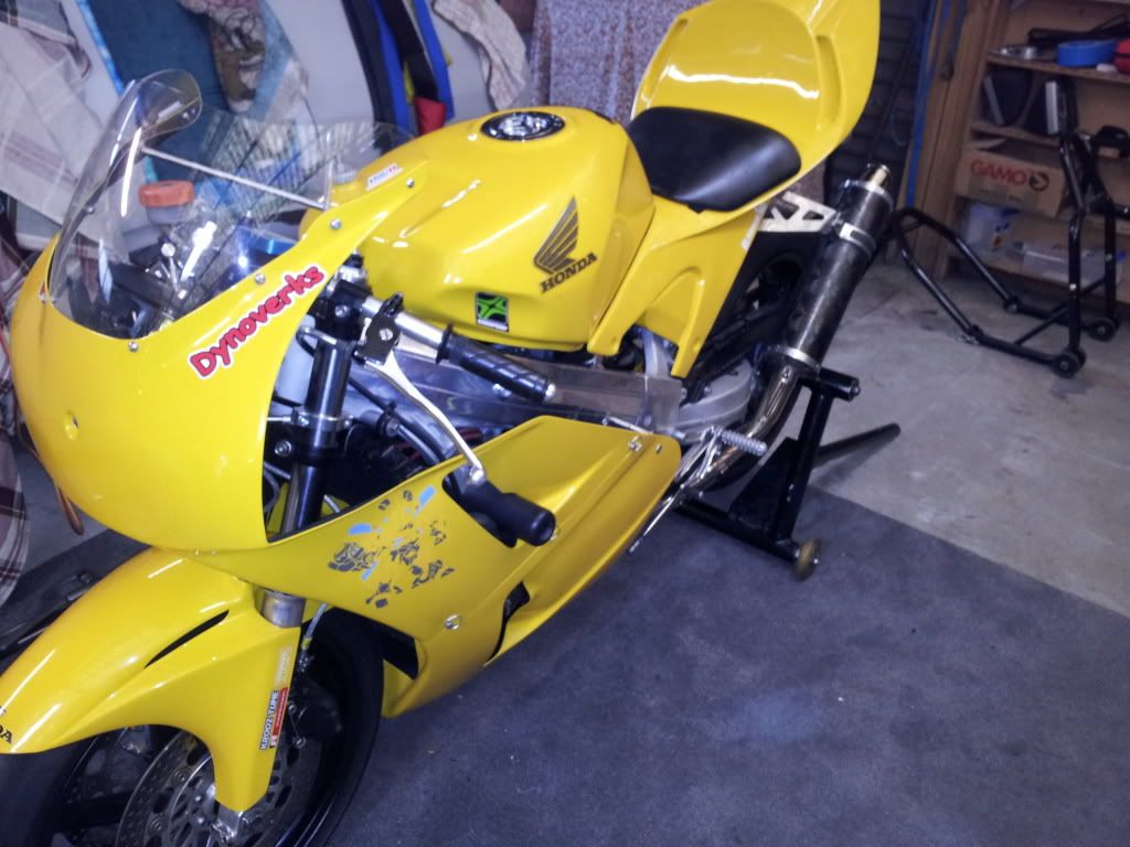

FYI the rest of the bike for those that are interested...
Fully rebuilt from the ground up:
HRC Carb and airbox setup - using 155 mains at the moment, but still too lean, moving to 160's.
Full stainless exhausst
unknown muffler!!
battle rearsets
xr timer
CBR1000RR fork internal cartridges
GSXR 600 rear shock
17 rear wheel
braided linies
tyga fairings
Custom subframe
race loom
HRC module
Fresh motor
GP Race chain
Carbon engine protectors and frame sliders.
made 159hp as it sits on the dyno, but as mentioned, it is a fair bit lean at the moment, and that was on a 45 Degree celcius day, so a bit too hot for making good HP will dyno after 160 jets installed, and on a cooler day so see where i get...

poomba2hd wrote:Question is, I am chasing spare parts for them (i.e. shifter/brake pedals/pegs) does anyone know where i can get them??
They're aluma-lite rearsets - no longer available.

You can get the Battle Factory stuff direct from them if you can't find an importer. Here in the States we have a few places that import their stuff.
Battle Factory:
http://www.battle.co.jp/
