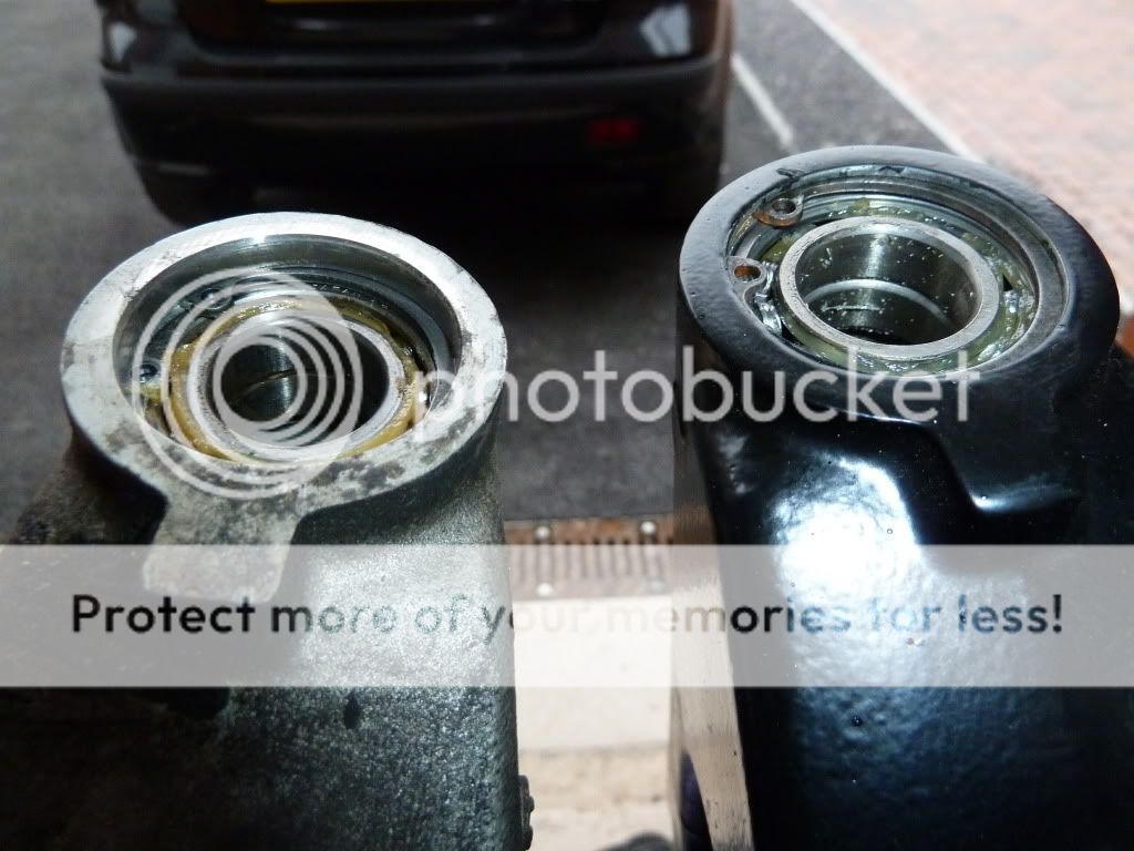

Took some pictures today for those who'd like to see the differences.
This shows the difference in depth NC30 on the left and what we think to be the NC35 on the right.
This is the pivot bolt and the bush on the left is off the 30 and the two on the right are/maybe off the 35 and have a smaller bore.

That black arm is an nc30 arm
