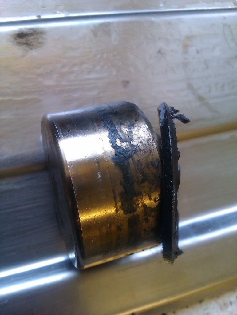

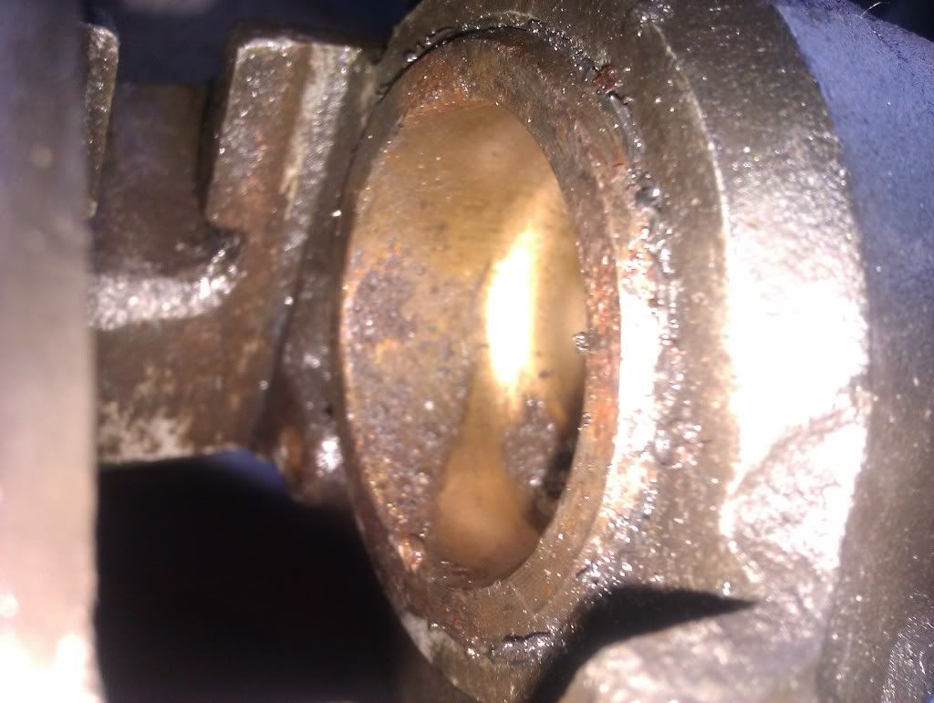

trying to unseize the pistons, got one out but couldnt get the other one out, tryed bleeding it out but didnt budge, tryed splitting the caliper and didnt budge lol.

I feel your pain.  I was doing that a couple of months ago.  I used a little heat from a torch on the outside of the caliper.  Then got vice grips on the lip of the piston and spun instead of trying to pull it out.  Once it spun a little you can start to try to slowly lift it out.  Of course the vice grips will ruin the piston.

yh i didnt want to use vice grips coz of damage, but looks like i wouldnt even get any grip on it anyway. was thinking split them and try and get it out then, but carnt split the fkers

You could always have it in a vice upside down and seriously heat the caliper with a torch and see it expands enough to loosen the piston a bit.

I usually pump the pistons out with the brake pedal, one will go first. I then lock this by putting a spanner down the middle of the caliper, this locks the first piston and then the second should start to move.

That's what I did with mine. They're a bastard to shift any other way.
That said, apply enough heat and the seals will be ruined so they should just pull right out.
