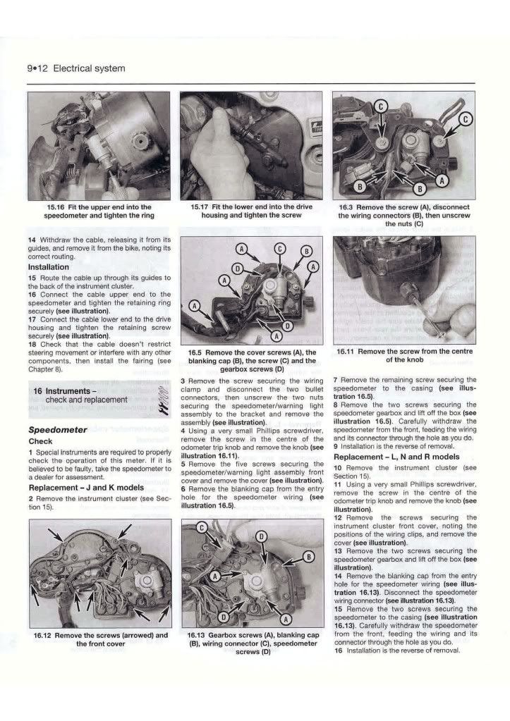

I recently bought a cbr 400 bt the speedo wasn't working.. upon inspection i found that the cable was broken from the sprocket end.. it still had the metal part of the cable in it.. i dont know how to install the new cable i bought.. should i take it to a garage ? i did a bit of googling .i can take the front fairings off and connect the cable to the speedo.. bt dont know what to do with the other end .. :S
i know it should go in this.. but how to do it exactly.. can any one help me with this.. pics or a video wud b great :)

Here you go this should help:

- Posts: 2
- Joined: Sat Jul 30, 2011 3:46 pm
Re: CBR 400 - nc23 Speedo Cable Installation
A littles problem tho.. the part where the cable fits on my bike isnt as same as the pdf u'we put.. it doesnt have two bolts you see.. i'd have to take that whole triangular thing out.. it has 3 , 8mm nuts around the whole thing.. the things is , are there small wheels in it ? If i take the whole metal thing out can i remove the old broken cable and install the new one and stil put the whole thing back together ? the thing is .. i dont know wats inside that metal thing :S
