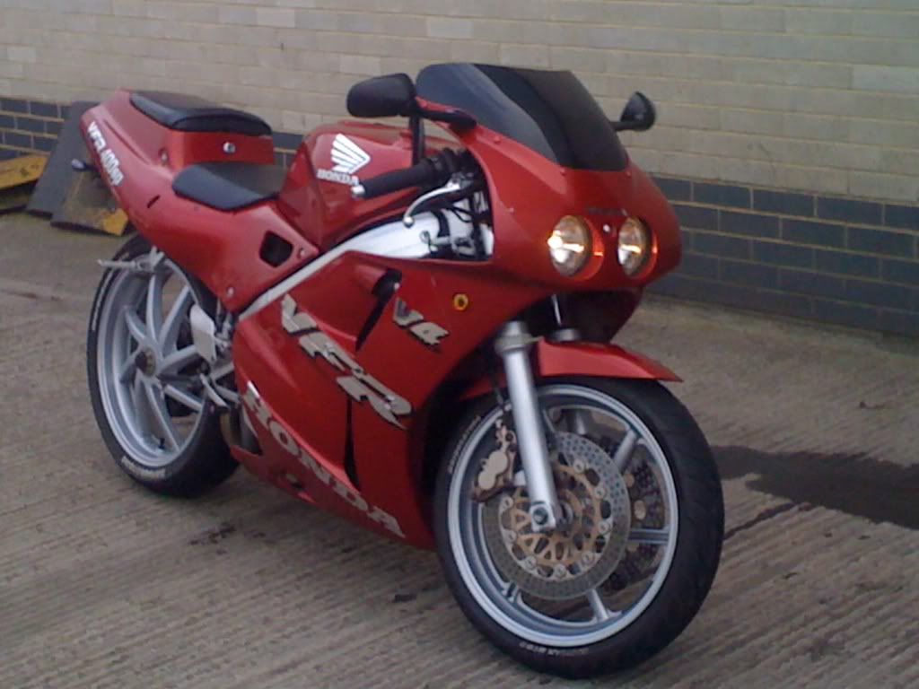

The picture below is my NC30 before she got hurt.

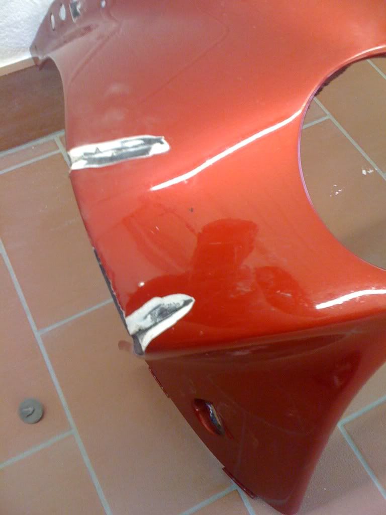

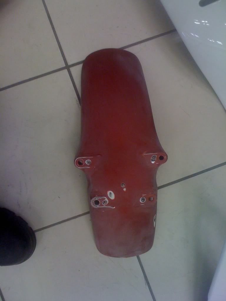

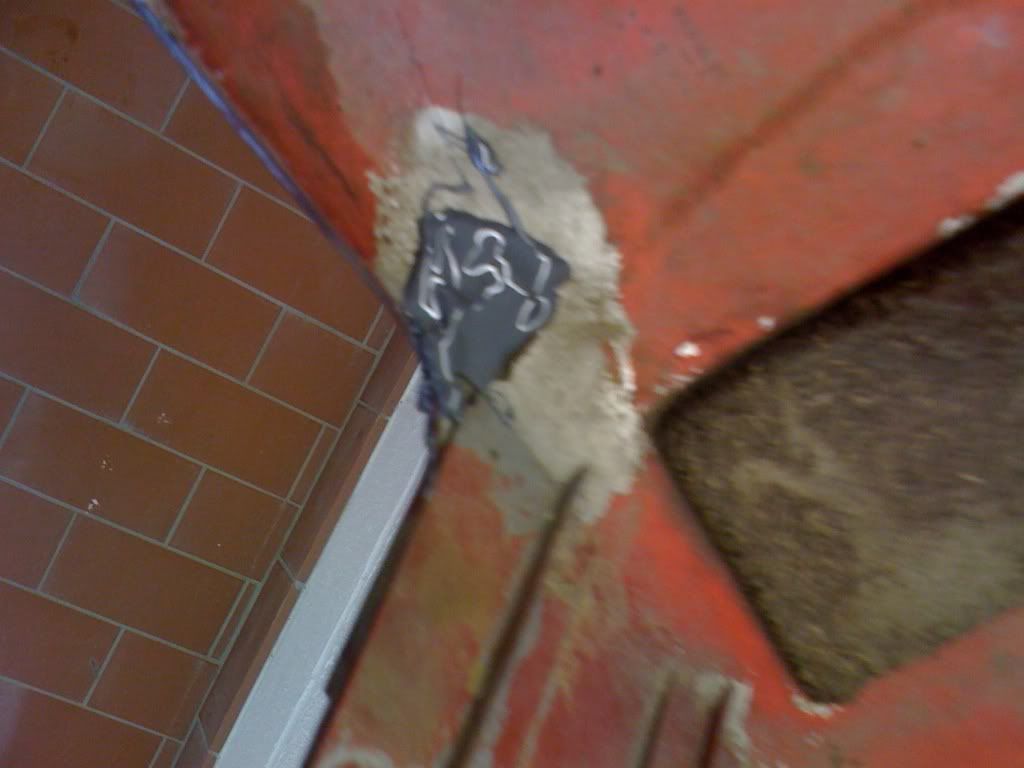

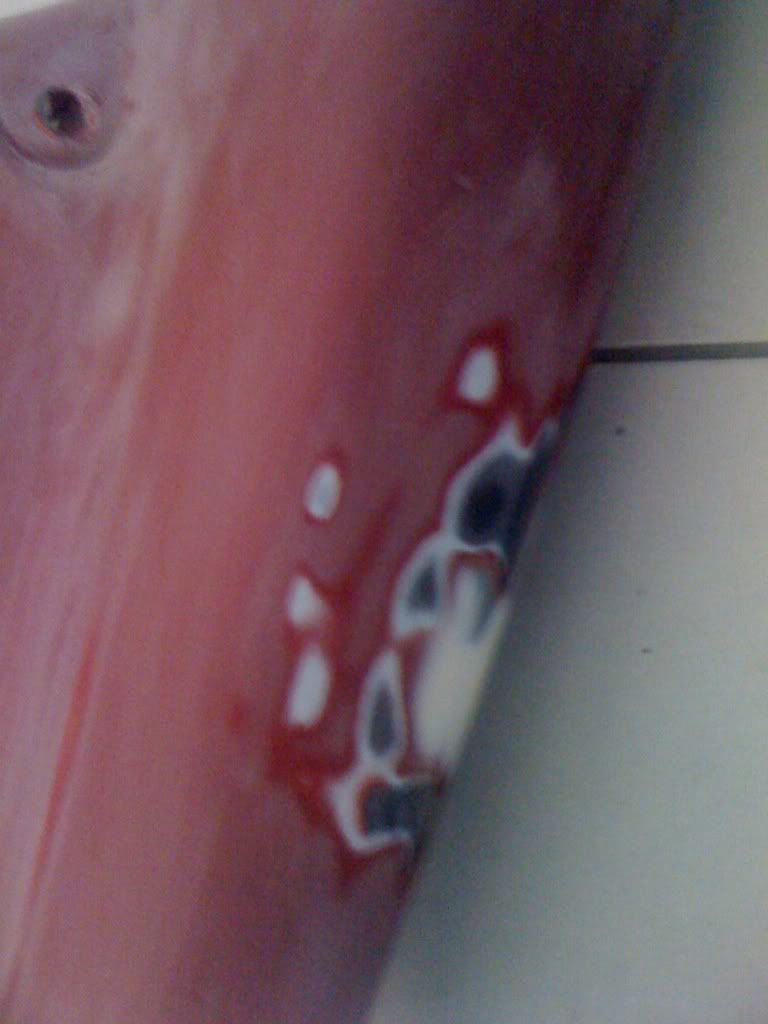

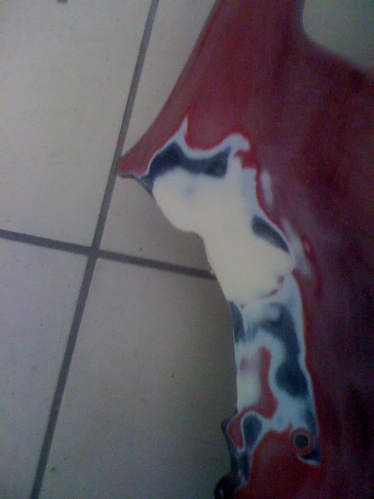

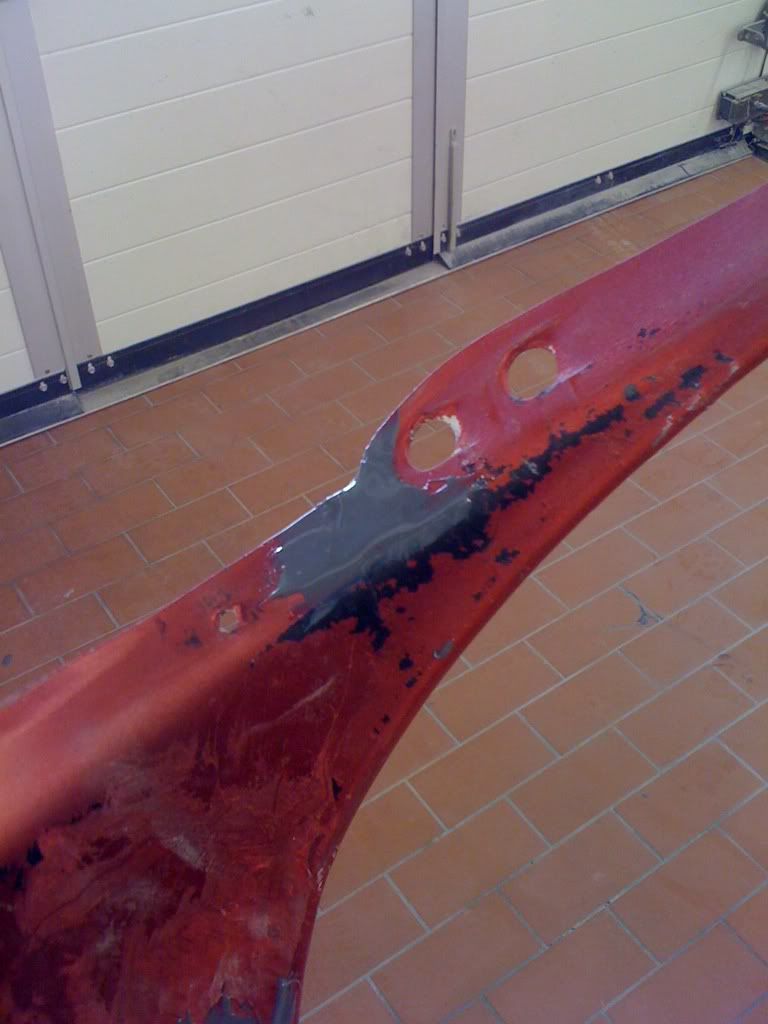

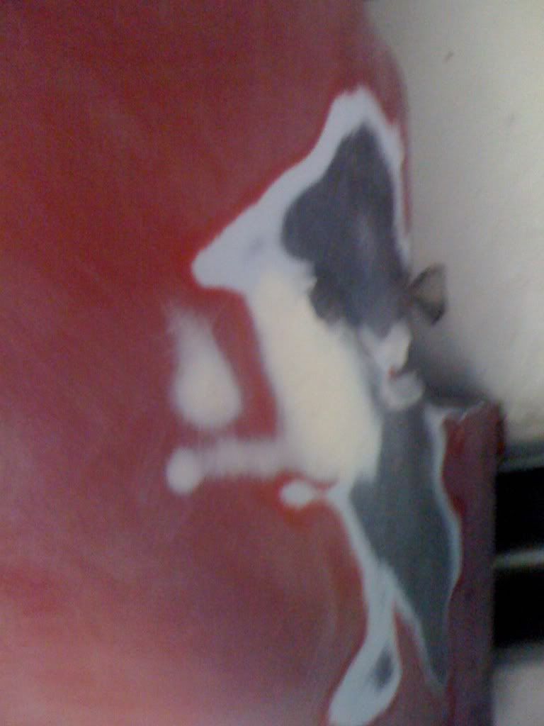

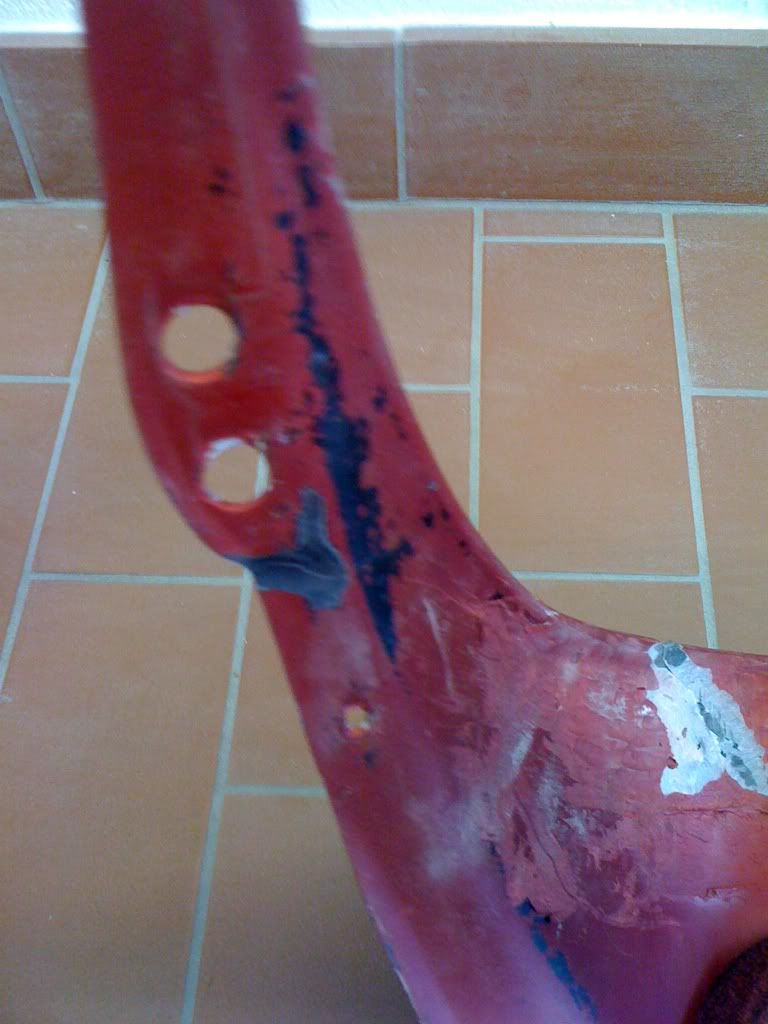

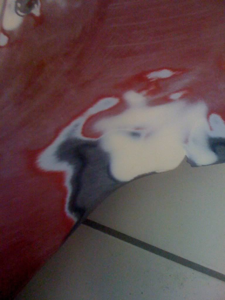

As I started to look at the nose cone I at first thought that the cracks were so big that I needed a new fairing but before I would get one I would at least try to fix it there was 4 separate cracks on the nose cone alone. There pictures alone should do the talking.

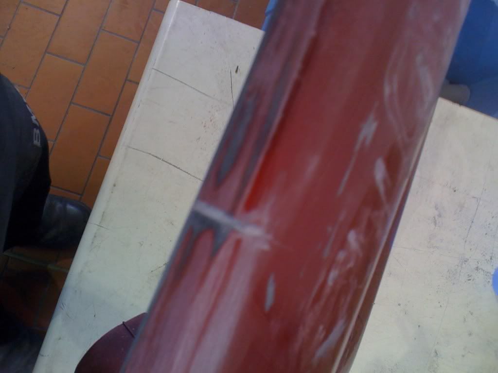

Then I had to apply to the glue to fasten the halves together.

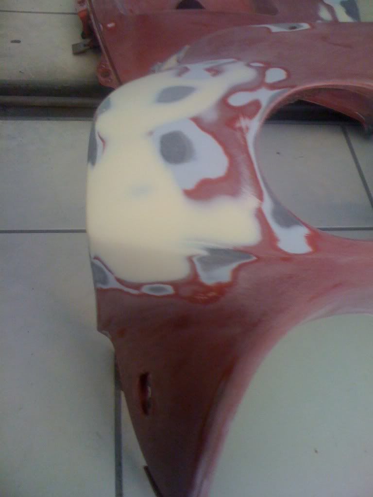

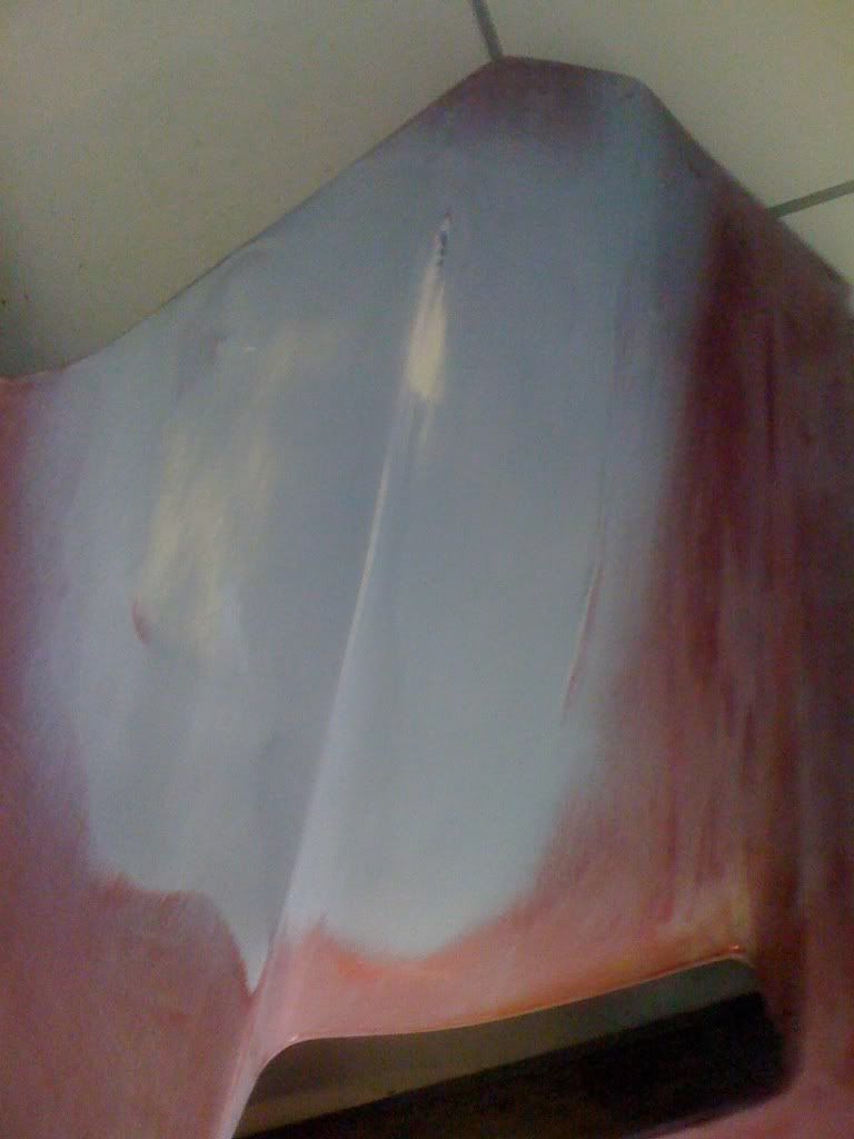

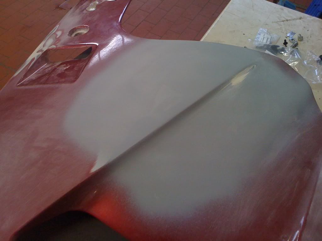

Then I had to smooth this down I used a sharp blade then applied on skim of filler smoothed it down then applied another skim.

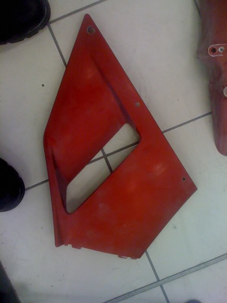

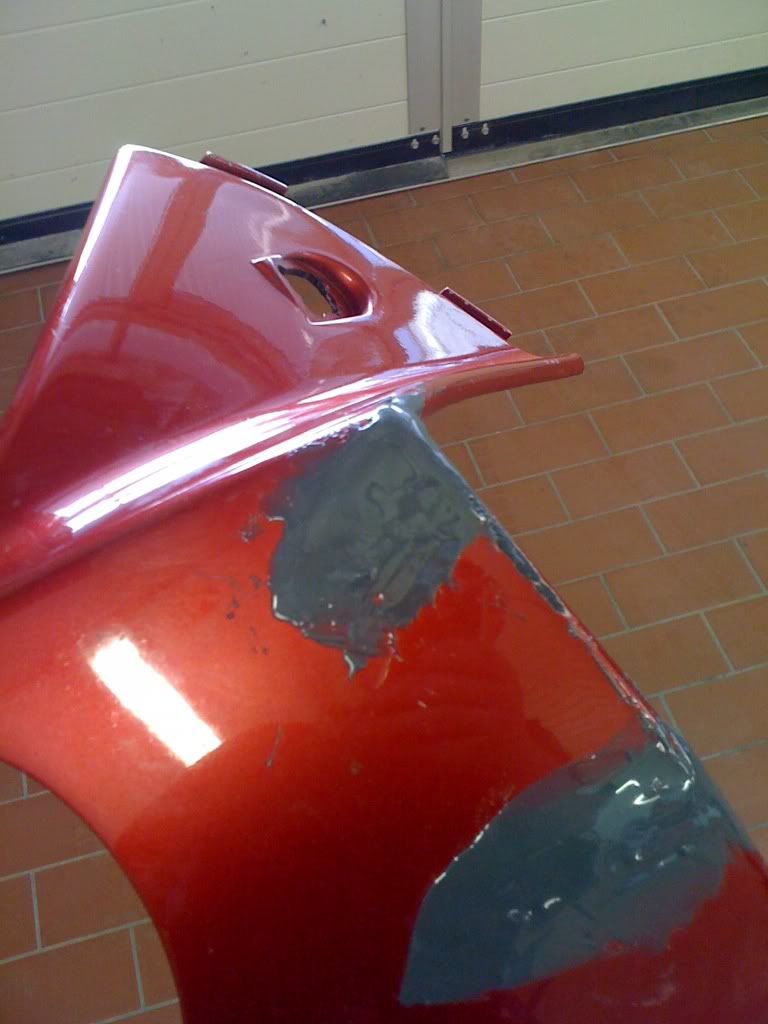

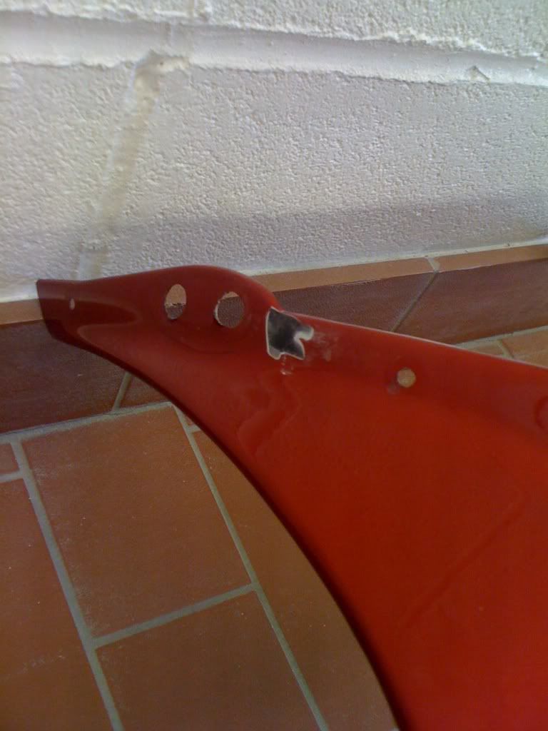

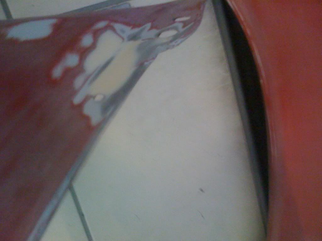

I then started to repair the seat fairings there was scuffs and there were a just hidden cracks from over the years.

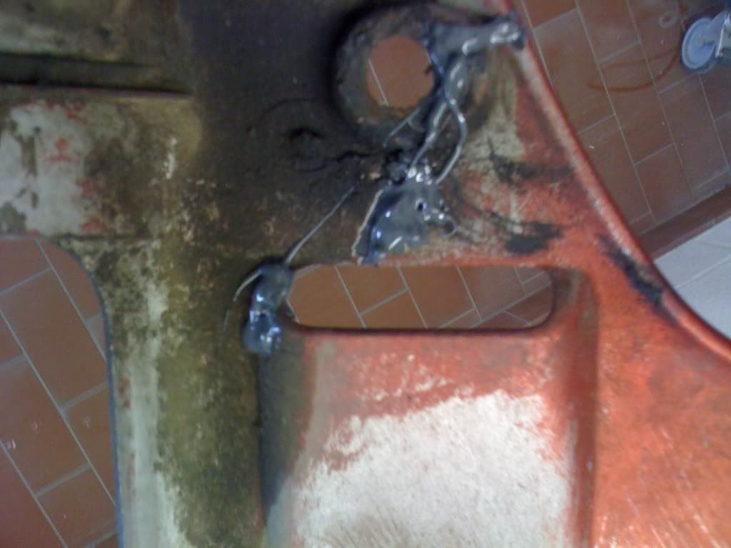

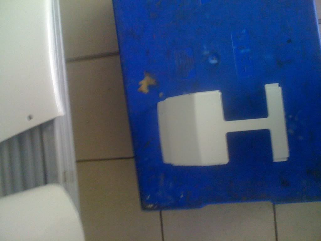

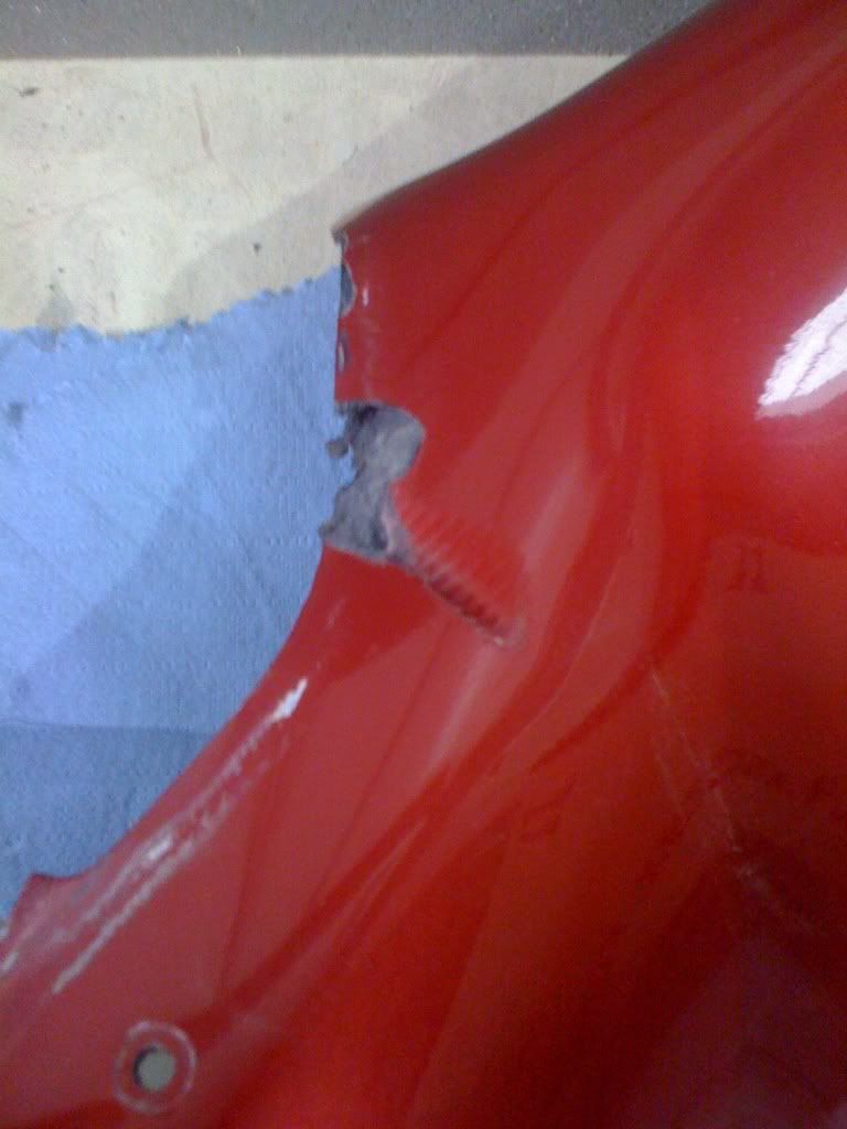

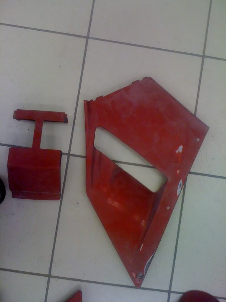

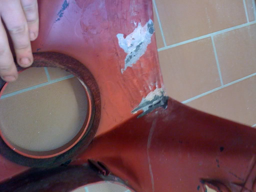

The side panels were really difficult as there was a huge scuff and I found it hard to rebuild the ridge as I couldn’t get the ridge correct. There was also cracks on the bottom of the fairings and one of the bolt holes had completely became separate from the fairing.
I sprayed a small amount of primer onto the fairing as it helped me to see the lines and improve where needed.

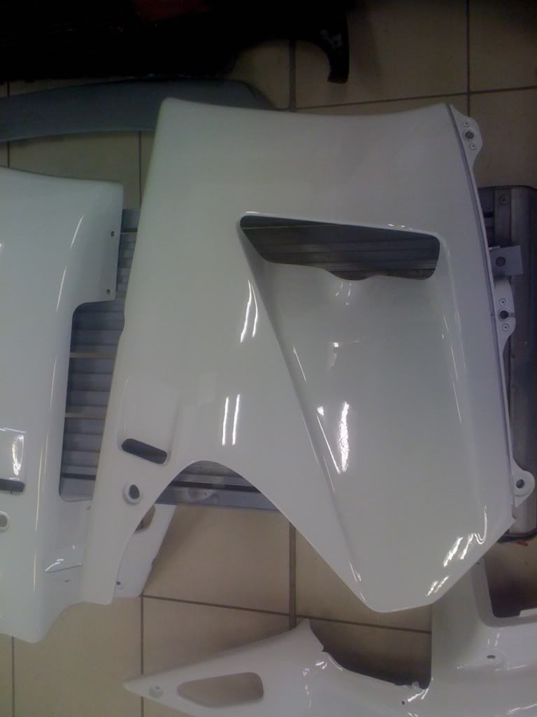

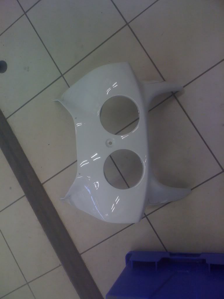

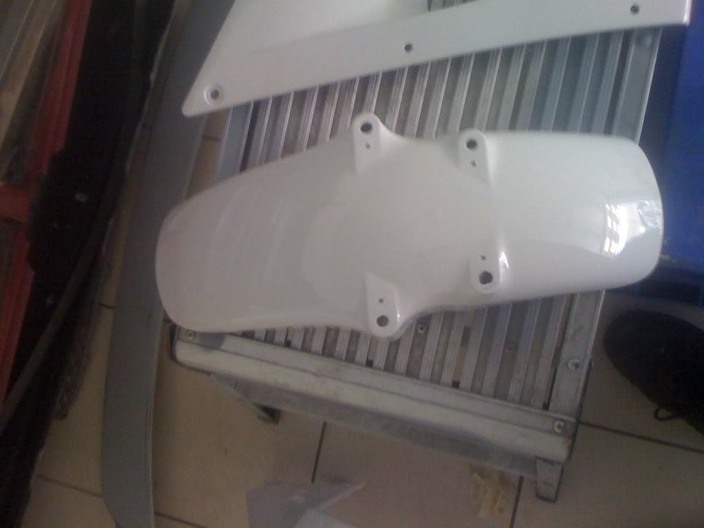

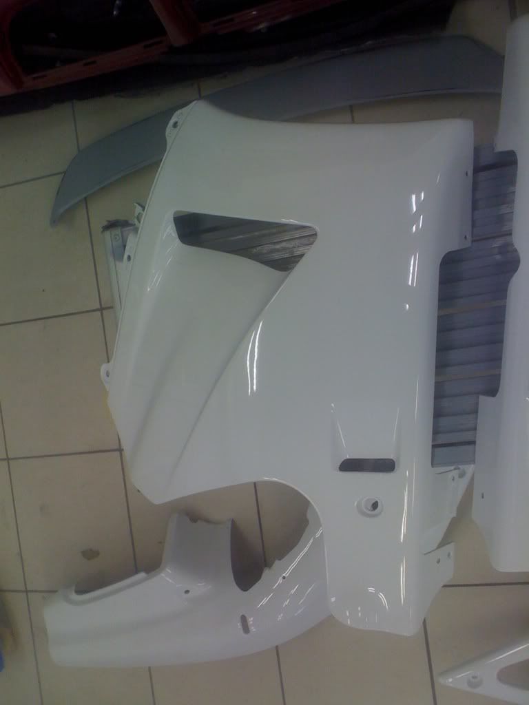

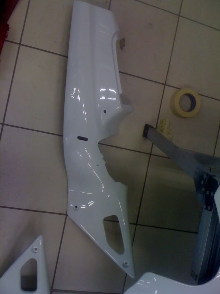

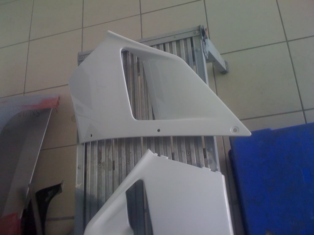

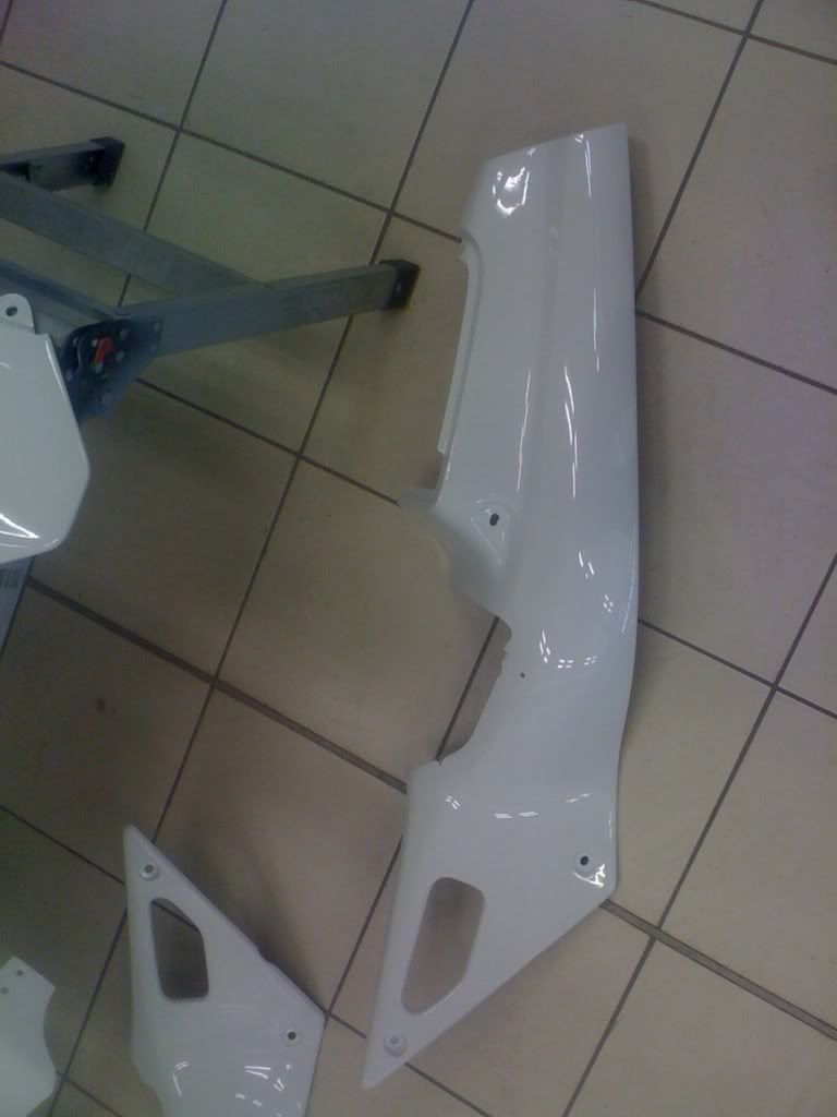

the bike is now fully sprayed and to start with I cleaned the surface and then I sprayed the fairing that had the filler into them (Nose cone, rear seat fairings both side and both of the bigger side fairing) the colour I went for is ASPEN WHITE as I’m a part of a BMW bodyshop so I went for a colour that was easy to recreate it when needed, so next time you see a white mini roof you know that’s the colour.
After I sprayed them I got every other panel from the bike and keyed them up using red scotch (not different to a brillow pad).
And I must say I was truly amazed at how lovely my bike is in white, all it needs now is for the Castrol graphics to be applied then she will be complete.
