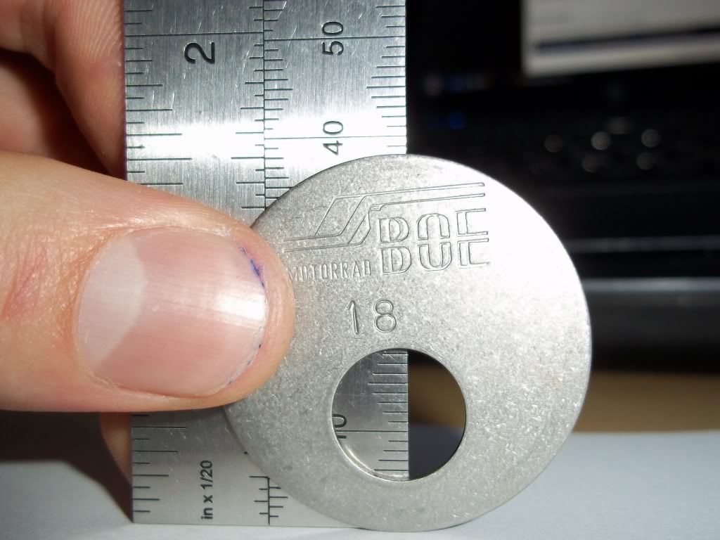

This is from when i took out my 3tj restriction washers.
I didnt have any Verniers that day so the measurements are pretty accurate but not 100%
Total Diameter - 38mm
Hole Diameter - 13mm
Thickness Approx 1mm

Re: fzr400 restriction washers
Just to be awkward mine seem to be 38mm exactly!
The position of the hole is important, it needs to be that low so when the throttle starts to open the air/fuel can be drawn through the closest point to it
