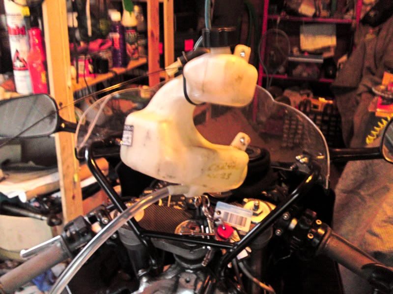

tanuki
Posts: 1571
Location: Nottingham U.K
Re: Spend £34 on a remote fuel tank so I can balance my carb
Post by tanuki »
If you look in this pic, hanging on the back wall btween the 2 posters you will see a bottle with a long black pipe attatched and sticking oiy of the top in an old funnel so you dont have to piss about when you want to top the fuel up
