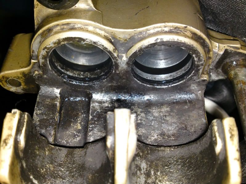

Hi all, having a few issues with the r/h front caliper on my '23... Gave the bike a clean the other week and whilst it was on the stands I noted the front wheel was reluctant to go round - but span freely after a palmthud or two to each caliper?
Aha. Time to service the sliding pins then... caliper was dually removed & the bracket cleaned, relubed and rebuilt.
Still same problem... removed caliper again, eased pistons out against an extension bar & carefully cleaned, lubed and pushed them back in, didnt look too shabby to be honest? Sliding bracket now has new sliding pins & seals, everything is rebuilt.
Nope. same problem... discs & pads are good, master cylinder isnt sticking in/on at the lever, brakes rebled with new braided hose a few months back in the Summer?
Fluid is midway between Hi & Lo in the reservoir, wheel will jam up on brake being applied, freeing on a palmthud to the r/h caliper - which would indicate to me pistons sticking/seal problems, master cylinder problems would cause both brakes to stick?

Sorted!
Dust seal in one pot had had enough, cue one sticky icky piston... stripped the lot out, cleaned pistons & rebuilt with red grease & new seals...
Caliper bled through real easy with the syringe!

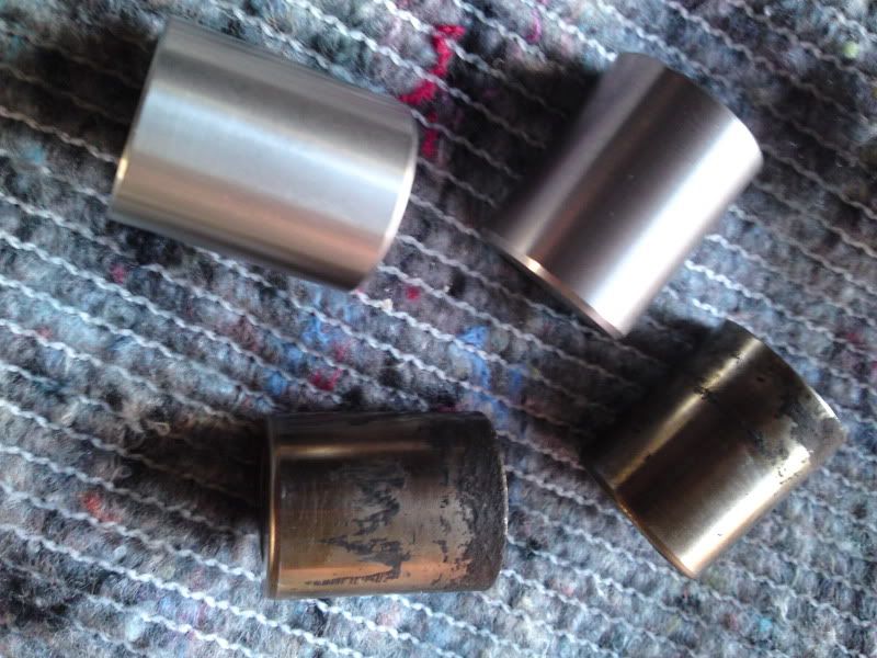

Spangly new stainless pistons with the old Übergak standard ones...
DSS wanted £15 per piston, paid £18.99 + £2.95 postage for these two, good machining quality, fit and forget with the stainless...
http://cgi.ebay.co.uk/Honda-nissin-cali ... 500wt_1156
Will fit NC24, NC23, NC29, CB6 Hornet etc...
The old ones were past it tbh? Usable, dont get me wrong - but what with the plating corroded thro I would just have been waiting for them to scab up again?
All good at the mo - reverse bled them yesterday with the syringe, filled up in no time, saved a hour of swearing trying to push air out of the caliper...

Good find. They look longer than the originals - is that just an illusion?
- Posts: 408
- Location: Trowbridge, Wilts
Re: NC23 front caliper sticking....
Possibly? They are 25mm dia x 31mm length, I will check the originals in a mo... fit the calipers ok anyways!Wozza wrote:Good find. They look longer than the originals - is that just an illusion?

Yep - originals are 25mm x 31mm, the same...
