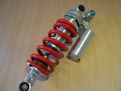

Also is this the sort of shock I should be looking for?
Its off of an 08/09 bike.
- Kayla850
- Posts: 717
- Bike owned: Sunn Tzar S2
- Location: County Durham
Re: FZR400 4DX/3TJ Fork and Shock Swap?!?!?
No, you need one of these-Bickers2208 wrote:Also is this the sort of shock I should be looking for?
http://cgi.ebay.co.uk/Yamaha-R6-Rear-Sh ... 2307fb1229
with the clevis at the bottom end.
I'm in Peterlee, my postcode is SR8.
There's no need to be local, I know exactly what to do
