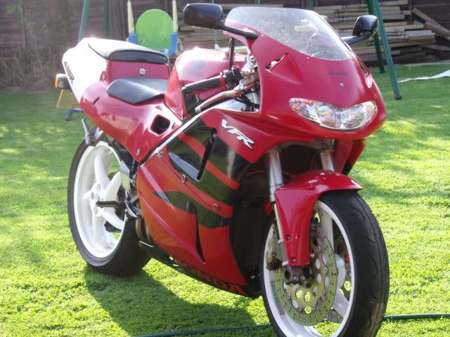

Heres a chance for some picture whoring! (Sorry)
My bike
My machinists bike
My bike
My machinists bike
