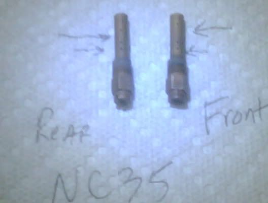

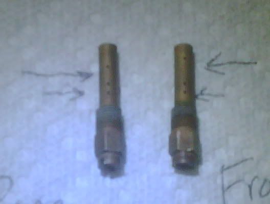

Post by 911f » Sun Aug 30, 2009 4:08 pm
here they are. sorry for crappy pics, used cell phone. but they are different. both have 3 sets of holes but different spacing:
front : highest hole much further away from the lower pair (away from main jet)
rear: highest hole closer to lowest pair - almost evenly spaced.
if you need more let me know
bill

Post by Cammo » Mon Aug 31, 2009 10:37 pm
The labelled pics above are correct.
