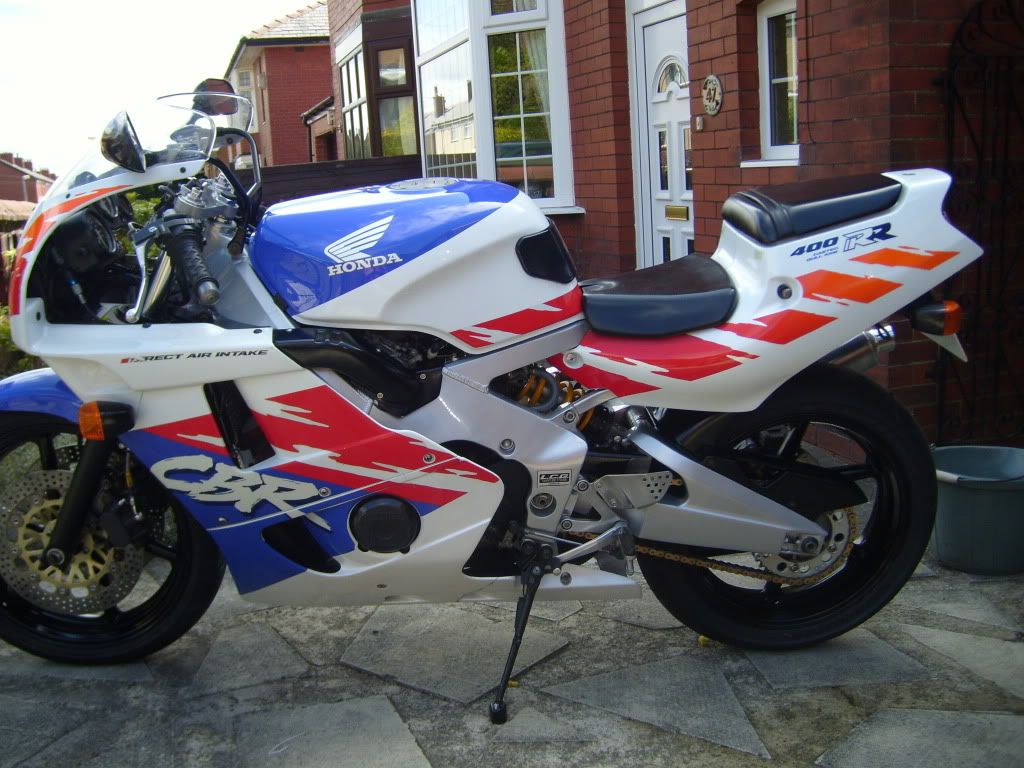

Its finally on the road, taxed, insured and mot'd
				cbr400rrn
 - Posts: 758
 - Bike owned: NC29 CBR600F
 - Location: Lancashire
From this
{IMG}http://i891.photobucket.com/albums/ac11 ... 1.jpg{/IMG}
To thisin a matter of a year or two ahem.
Just need a new bellypan and well, it will never be finished if im honest i shall always find something that needs changing.
A big thankyou to all who helped and those that didn't know it as well.

Nice job! Good to see a bike on the road rather than in bits and sold on ebay!

nice bike u have there mate! soo tidy

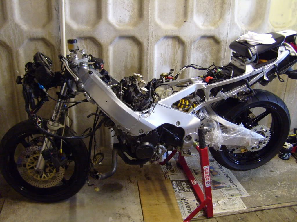

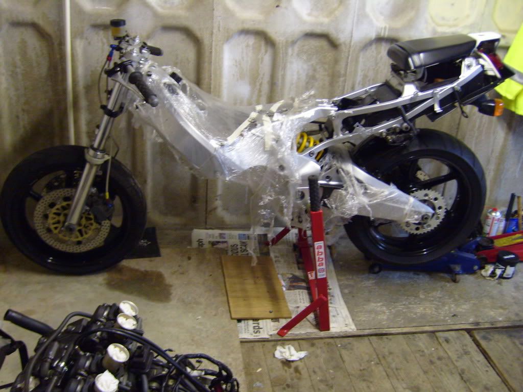

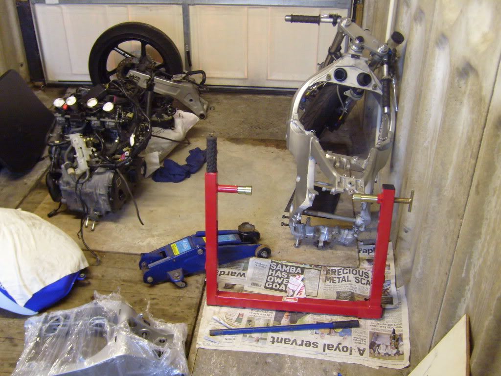

I replaced bearings everywhere, wheels painted, the mainframe, rear subframe, swingarm were powdercoated. I decided upon this as the mainframe was found to have a crack in the welding around the headstock and the swingarm chain adjusters were tapped and rethreaded by previous owner and were done wrong and werent useable so another frame and swingarm were purchased and powdercoated. New braided lines up front, Front forks are from an RRR model set up for my weight from G.F with powdercoated bottoms along with the 600 shock which was also purchased from him along with other bits and bobs (also set for my weight.)
New chain and sprockets, new tyres (090), everything that was ok to use was taken apart and cleaned up to a level were i was happy with it and put back together. All the other photos that i have are of little relevance really they just show bits of wiring routing (which is recommended to be done if anyone undertakes something like this as you will forget) or brackets.

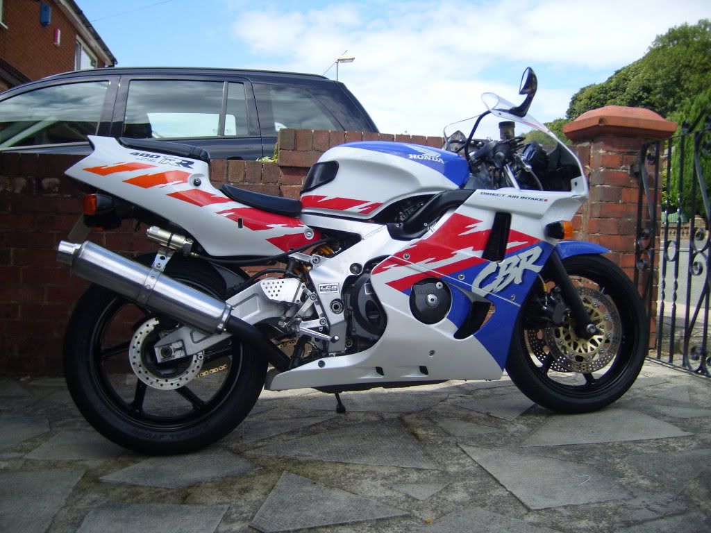

A few more pics now i know how to do it
Thanks for all your replies its cheered me up for the day
 , never taken on something like this before, some of it was hard work to figure out but it's been more than worth it and i'm keeping it forever as it is an ongoing project and it handles like a flaming dream. So never mind buying race cans as soon as you buy a bike and spend the money on suspension and you will never stop smiling when your out on the road.

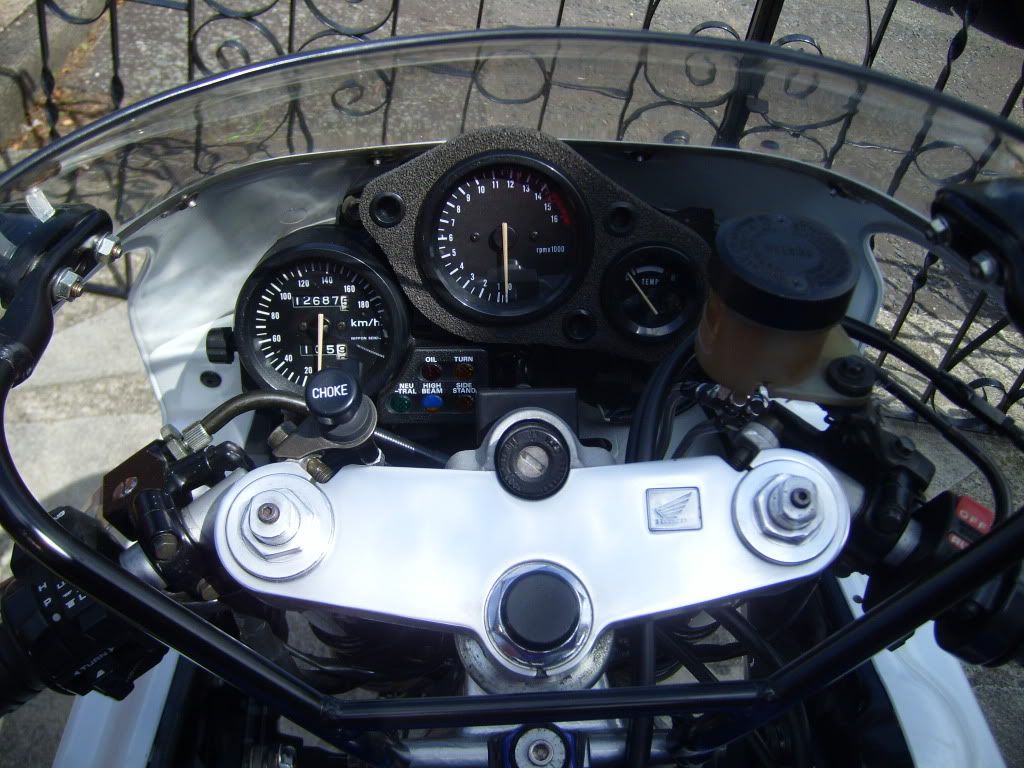

Can I ask, what are those fork tops? Are they from an R model? (Never seen an R model in the flesh).
						Top bike mate!
				cbr400rrn
 - Posts: 758
Re: Its finally on the road, taxed, insured and mot'd
The whole forks are from an R model from Graeme France

What 600 did the shock come off of? Did it bolt right on?
