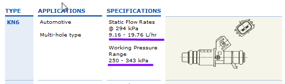

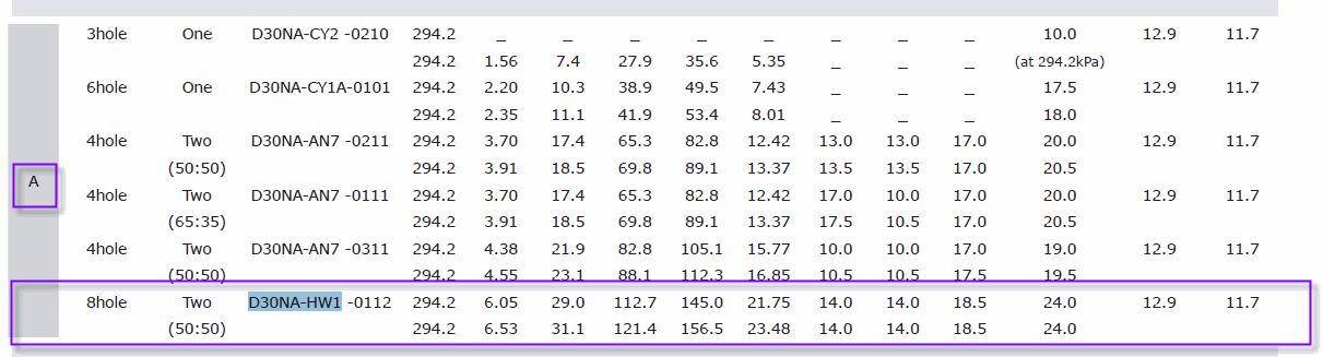

2. Fuel injectors. I think you can buy any from 400cc or 600cc bikes latest model will be more than enough - http://www.useasydocs.com/details/inject.htm I'm using jets from CB400 - Keihin R WH01
3. Fuel pump - I'm using CBR600RR, because it provide me suitable presure 250-343 kPa and easy to fine and replace.
Fuel preasure at idle: 343kPa (35kgf/cm2, 50psi)
Fuel pump flow (at 12V): 167cm3 (5,6 US oz, 5/9 lmp oz) minumum/10 seconds
