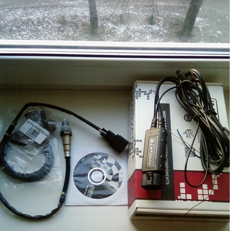

Received all other stuff.
1. Innovate LC-1 Bosch 02 Sensor and Lambda. Really this is good thing ever for bike without fuel injection, because easy allow you to detect are you running LEAN or RICH. You can trace air\fuel ration (AFR) with laptop or gauge.

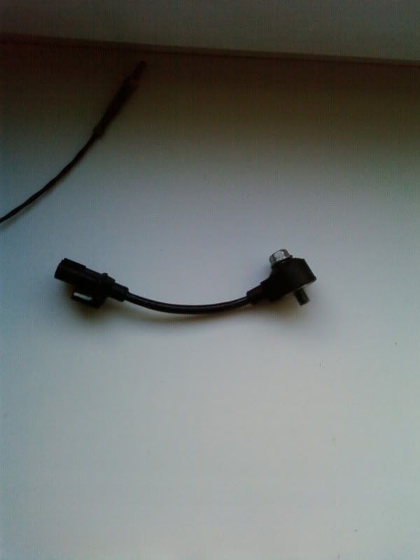

3. Knock sensor from CBR600RR. Look like you can use from car, this is one little bit smaller.

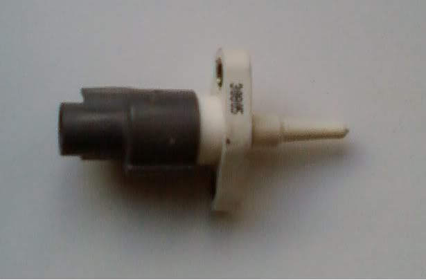

4. Intake air temperature sensor. From CBR600RR

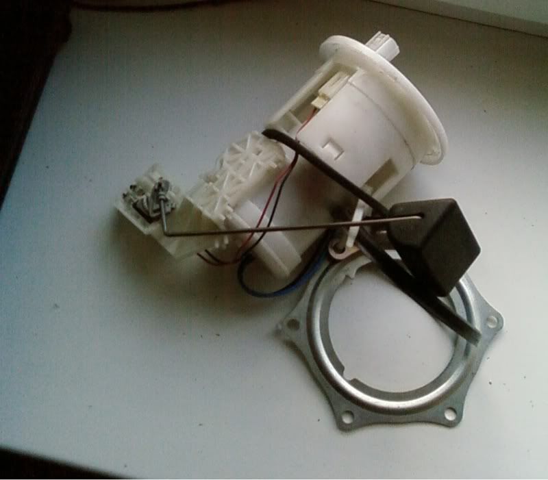

5. Fuel pump with fuel level sensor. Also from CBR600RR. Need to fabricate fastener to fit this to NC29 fuel tank.Image

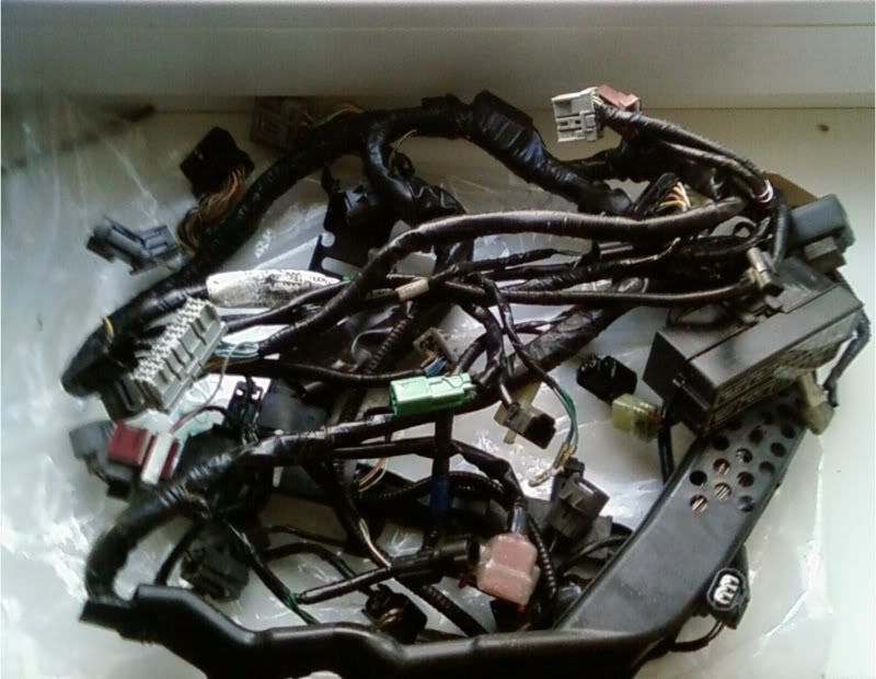

6. Bought full wiring from CBR600RR, because it cheaper than getting individual connector for other stuff. And it also had small automotive relays - I think it can be also use in project to save some room.

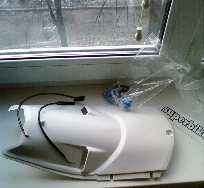

7. Undertail unit with LED turn signal.

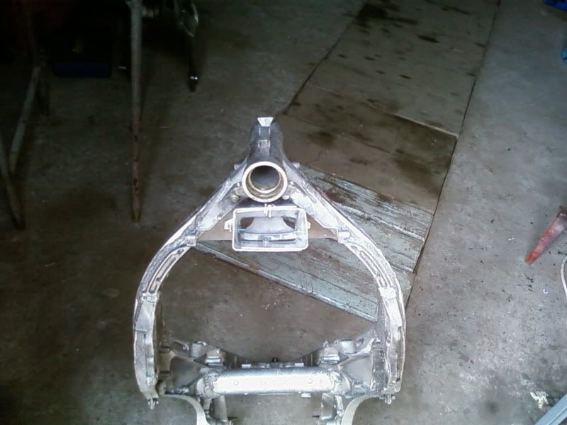

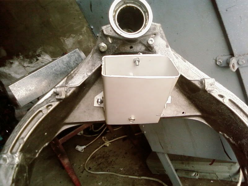

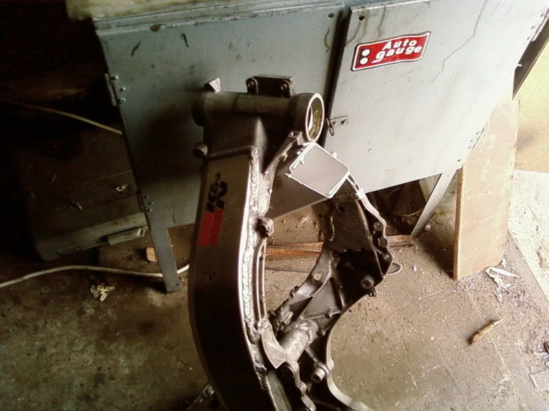

What do you think about such type of RamAir ?
Fabricate simple model of the ram air I'm planning to use. Of course, there is no dirrect airflow like in HRC airbox, but should be not big difference and you will be able to use stock airbox, and do not need to looking another place for HT coils.
This is just model, will be done from carbon soon.
