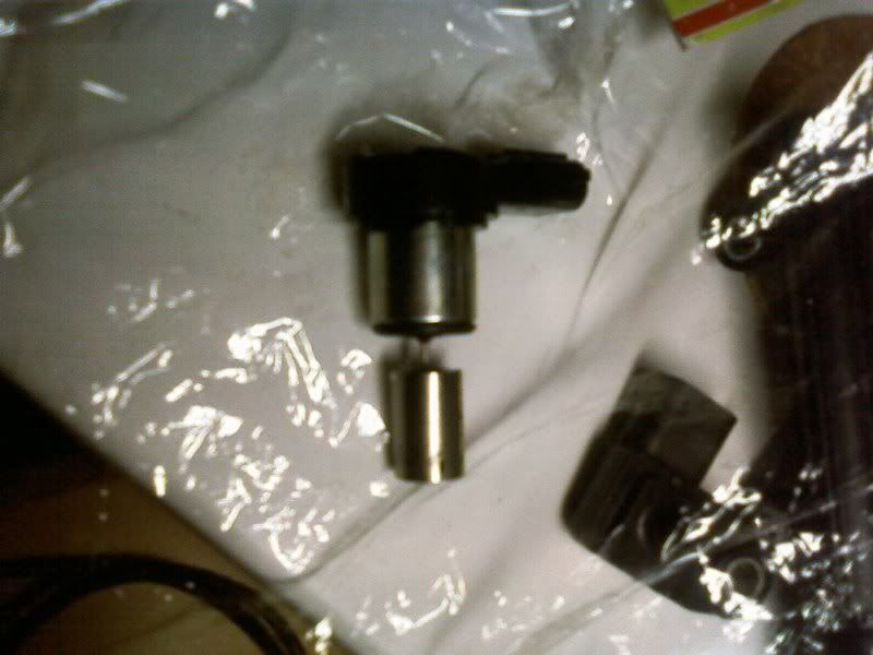

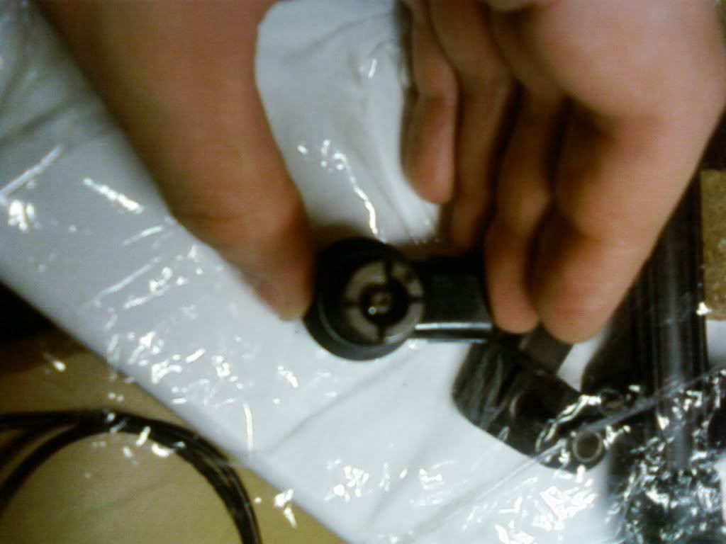

Camshaft is not balanced by default - so, welding small piece of metal do not disbalanced it, so we shouldn't get any camshaft vibration due to this theeth. But before I was thinking to use such sensor from CBR600Cammo wrote:Yeh that looks like a better option, although welding something onto a camshaft is not something I'd like to try!![]()
Any hall effect sensor can be used, looks like durbahn also made a custom mount for the sensor but hard to tell in the pic.
And fix it on the top of the cover and one the side of the engine head - something like this.
Of course, I need to check posibility to make mount and Durbahn also remove quiet gear what I don't like to do. So, maybe in case of CBR400 better to fit sensor on the end of camshaft - looks like we have plenty room for this.

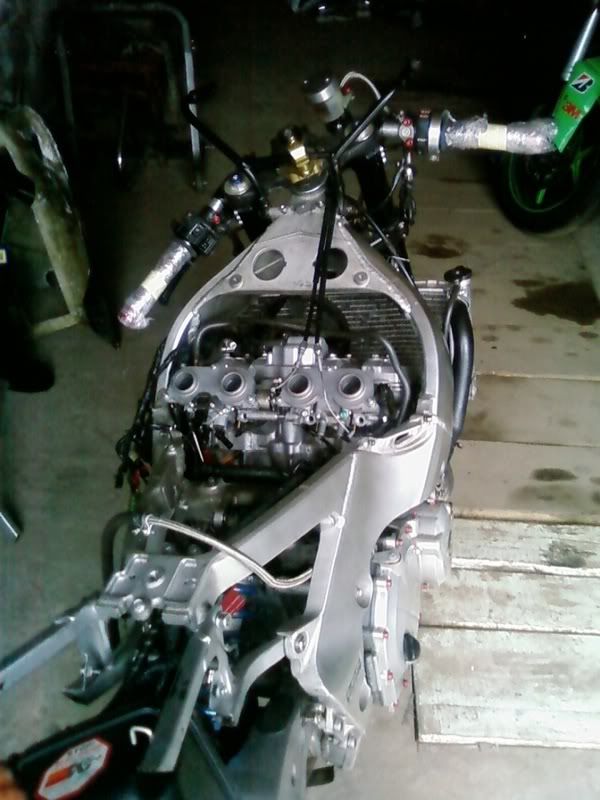

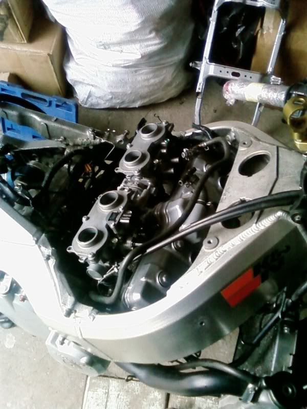

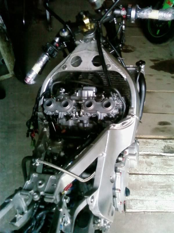

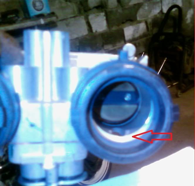

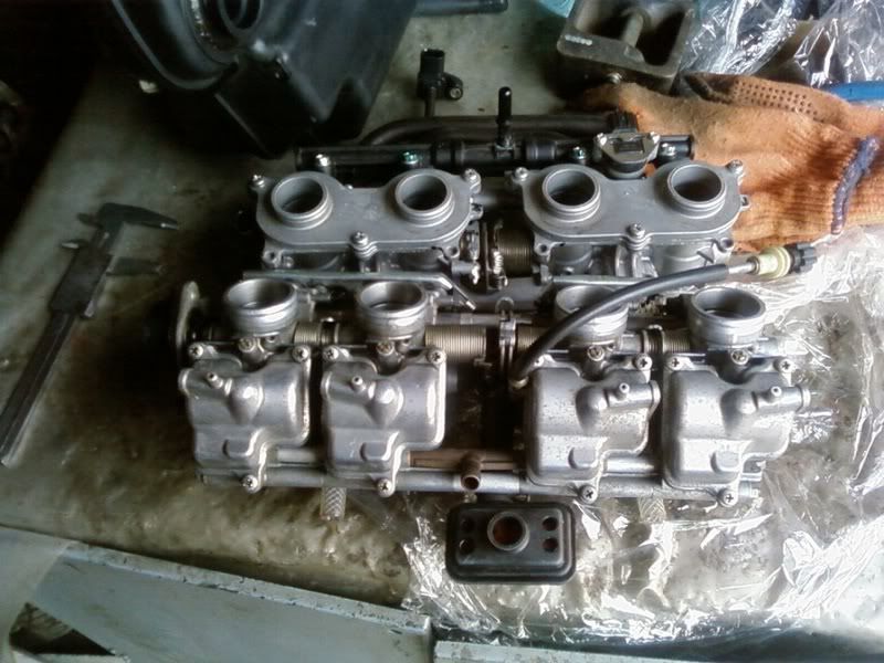

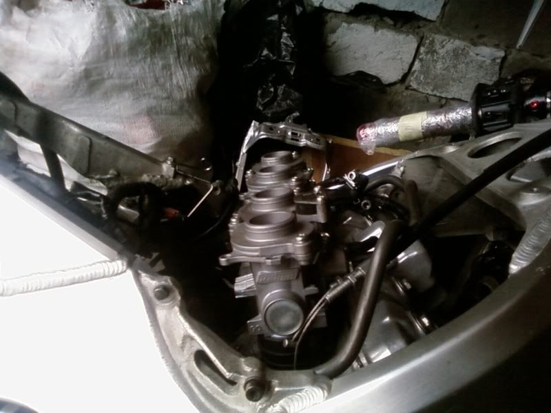

Today spent half day fitted throttle bodies. It is not absolutelly bolt-on, because CB400 Throttle bosies shorter than CBR400 carbs ( to be opened GSR400 throttle bodies can be successfully use, so do not bother buying only CB400 Revo because it very rare for now ). As I planning before carb rubbers allow to shift +/- 2mm. So, enjoy the pictures... now it's only partly fitted.

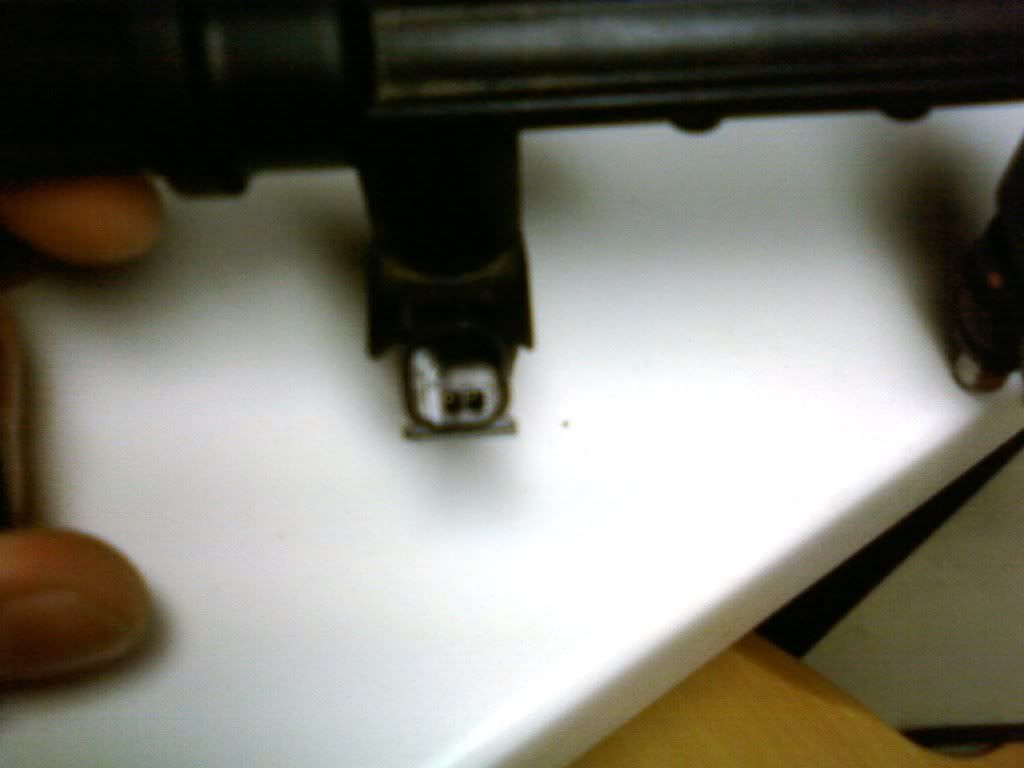

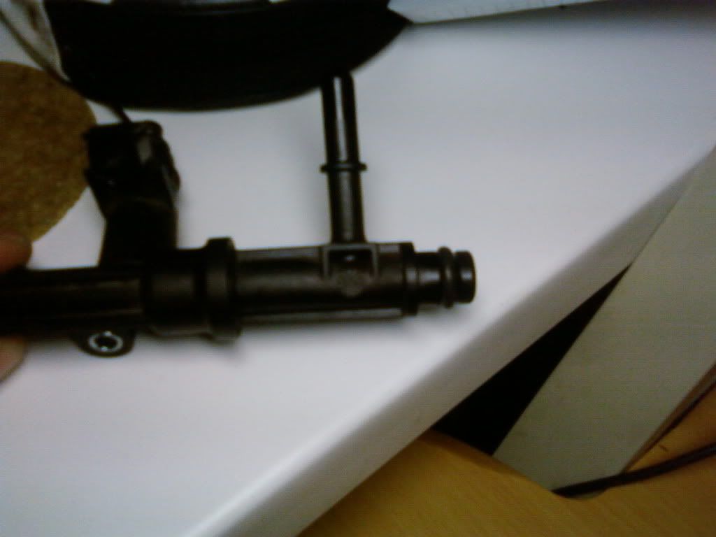

I have got the list of action need to be done to fit TB properly.
a. Because I have to extend pairs of injections up to 15mm. I also need to increase lenght of the stem that join pairs of TB. Also need to 15mm adapter to join pairs of TB.
b. Idle Air Control (IAC) is most significant problem for now, because IAC (4 wire stepper motor) doesn't not support by Microsquirt. So, I have couple of options
- not care about idle air control for now, and after all system will be run - start to tune it and fix in one position suitable for good idle control
- replace it with 2-wire valve, but not sure about this for now.
- buy stepper motor drive and try to make all this running ( convert PWM modulation to signal for spepper motor)
с. Change little bit angle of throttle cable guide.
d. Idle air tube need to be increased (maybe)
e. Middle fuel pipe also need to be increased.
f. Need to find plugs for (all prugs except jets is same - 3 wire connectors)
- TPS
- injector jets.
- IAC Stepeer motor
- MAP
g. Air box also need to redesigned - at least this part that join to TB.
h. TB need to be file down for better airflow. I not planing do this now, but this better to do sometime ago.

Hi Parus,
great work!
I think maybe (perhaps!) you need product 192148 here:
http://www.vehicle-wiring-products.eu/V ... usings.php
They look identical to the plug used on my Triumph's injector system. The little metal clip holds them tight despite vibrations, and there is a small rubber gasket inside to keep water and corrosion at bay.
I do not know if it is relevant... but on Triumphs with this style of throttle bodies there is also an IACV, but on race bikes it is not uncommon to disconnect it and throw it away (it's kinda heavy) and simply make up a very simple bracket like a throttle stop on carbs. The benefit of an IACV is it meters exact amounts of air, so you can set the tickover very precisely, and you should get a nice level tickover. However, it is not essential.
Maybe you can buy a used injector loom from another honda? Then you have your 4 plugs (I imagine they are always the same?) and it's all nicely put together for you. Just a thought, eg this one, and at that price it has to be worth a try?

amorti wrote:Hi Parus,
great work!
Thank you for information mate.
I found that ZX-6R 07 having same plug for additional jets inside airbox. So, planning take plugs from Zx-6r. Also I will take cbr600rr 07-08 harness - the conectors should be same for TPS, Idle Air Control, Fuel pump. And in future I'll try to use parts from CBR only.

2. Finished fitting throttle bodies and airbox - will make video this weekend.
