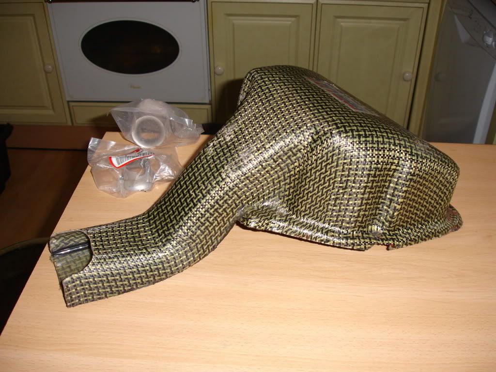

Rick doesn't do a ramair kit. You can get HRC repro airbox lids that go with an undertray, but the HRC set-up never used ramair, so you'd be best to check out after market ramair kits from RLR and similar.Joeblogs wrote:Cheers for that, sorry for the confusion, I only use it on the track, I have a 07 Tuono R for the road. Does rick do a ram air, air boxs and snorkle?
Also is the snorkle the aluminum inlet thing that comes out over the radiator.
The snorkle is that rubber thing on the front of the standard airbox. Most ramair kits use fibreglass lids that have a longer one that comes down and out the top of the radiator.
Here's a pic of a ramair lid (slightly bodged up and on the extreme side!).

That's the NC35 HRC airbox lid and will work a treat if you do the rest of the HRC 35 mods (slide springs, velocity stacks, needles, jets, etc.). It's still not overly difficult to get those parts these days (in fact there was a full kit on eBay last week).
But it's not a pressurised ramair set-up, so depends what you're after.
