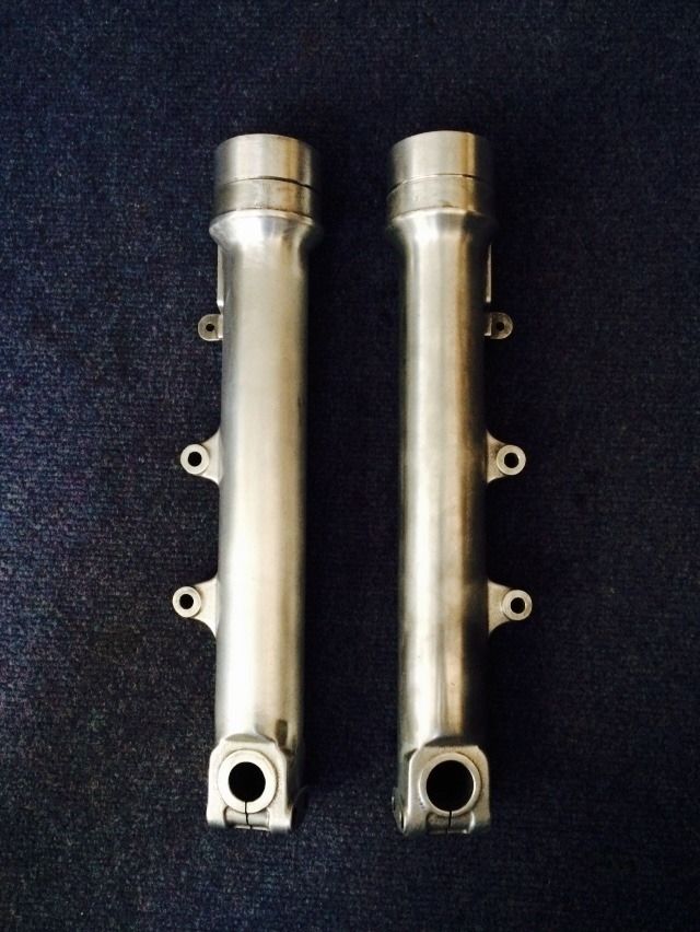

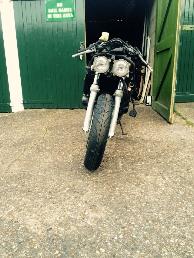

So thought id just do a little update on the progress on this and the problems i ran into + some shocking work that was undertaken on my front forks prior to ownership, excuse the pun
rebuilt forks - seals, new stanchion, powercoated.
rebuilt front and rear brake calipers.
new pads EBC sintered hh
braided brake hoses
powdercoated rear subframe.
powdercoated wheels.
new bearings all round.
new tyres bridgestone 090.
changed exhaust back to standard
polished top yoke and clip ons
oil, filters, coolant change
de-rust inside of petrol tank
cleaned the hell out of everything

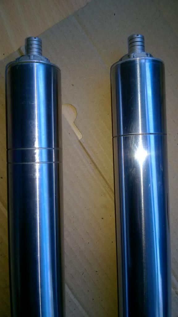

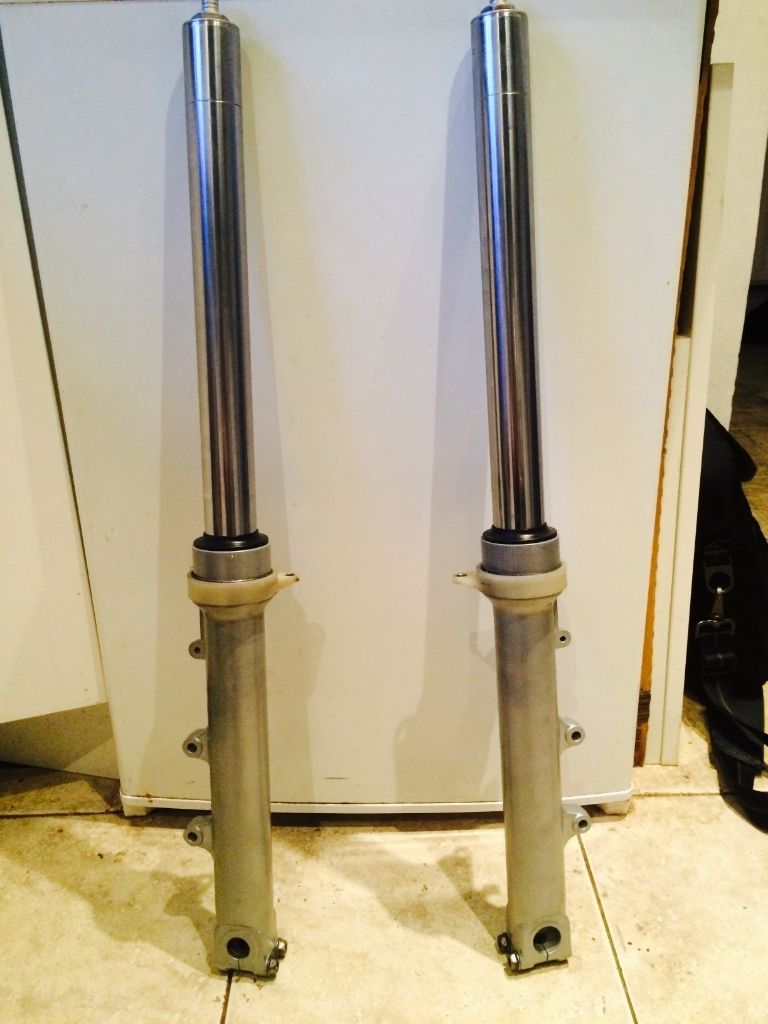

Glad I did the forks myself as it appears some shoddy garage in Suffolk had changed one of the stanchions and fork internals for something else off a different bike, springs were different lengths and the damper was different too... I can only think that this is pretty damn dangerous as the forks will be rebounding at different rates and must of affected the handling. Its back to how it should be now though but to think this was done by a 'professional', dear o dear!
Will add some pics shortly.

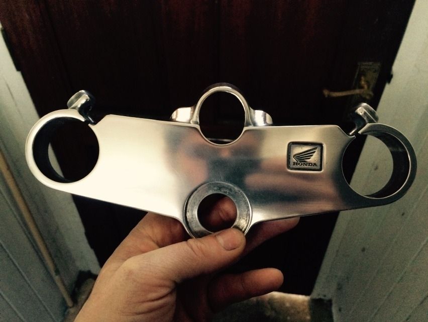

My polished top yoke:

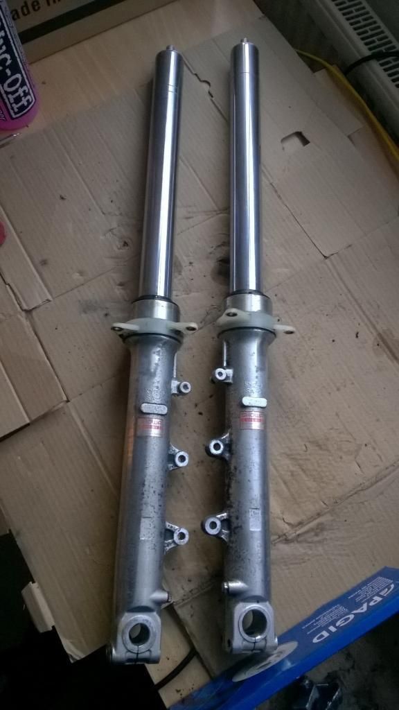

Forks off:
something not right here...

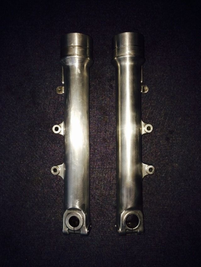

forks stripped:
sanded:
powdercoated and rebuilt with new seals:

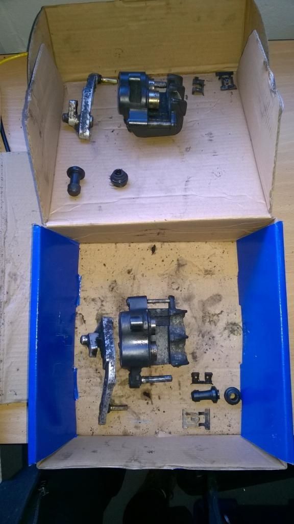

Front callipers ready for stripping:

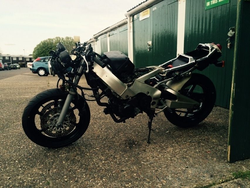

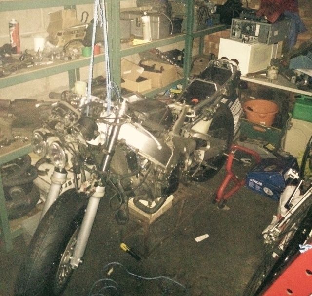

starting to come together again:

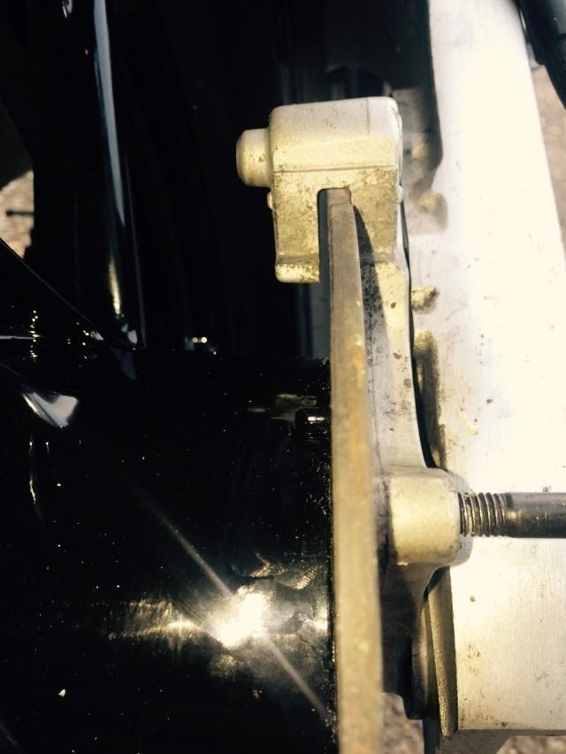

I put the rear wheel back in last night but i notice the calliper carrier is in contact with the brake disc, the wheel still spins but there is some rubbing going on which is slightly worrying... still to mount the calliper itself though so i wonder if that will pull things in line.

Looking good! Have you got all the spacers in the right places on the rear wheel

hmm actually looks like i might be missing part 42625MV4000 so ive just ordered that and fingers crossed that will sort it.

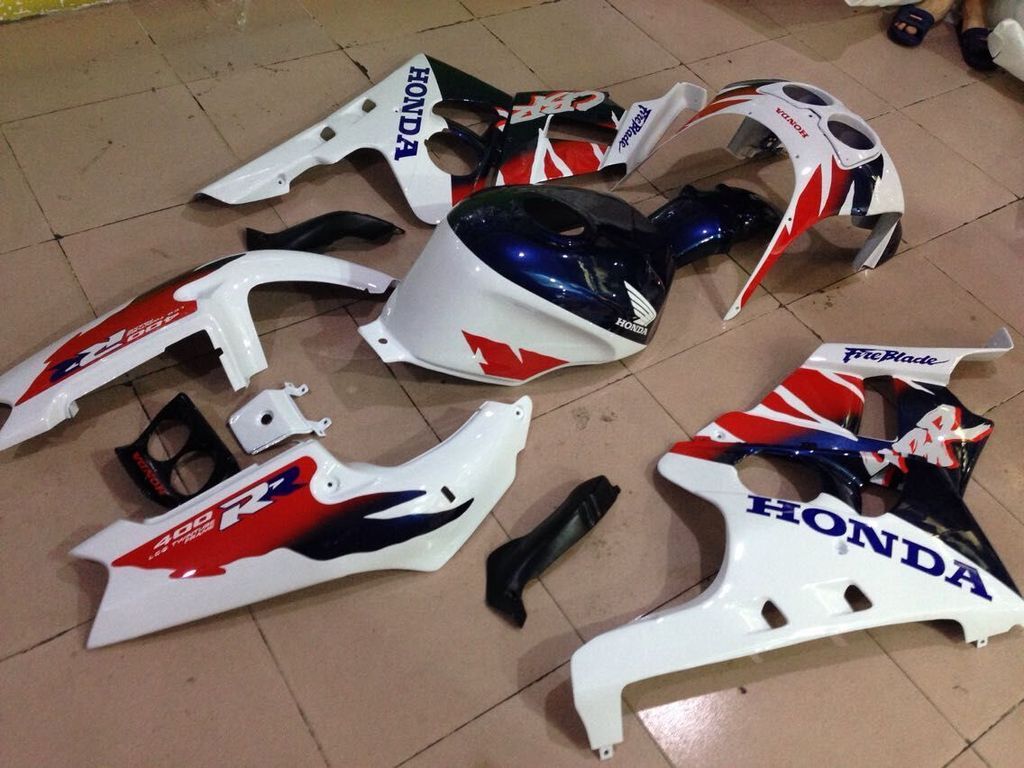

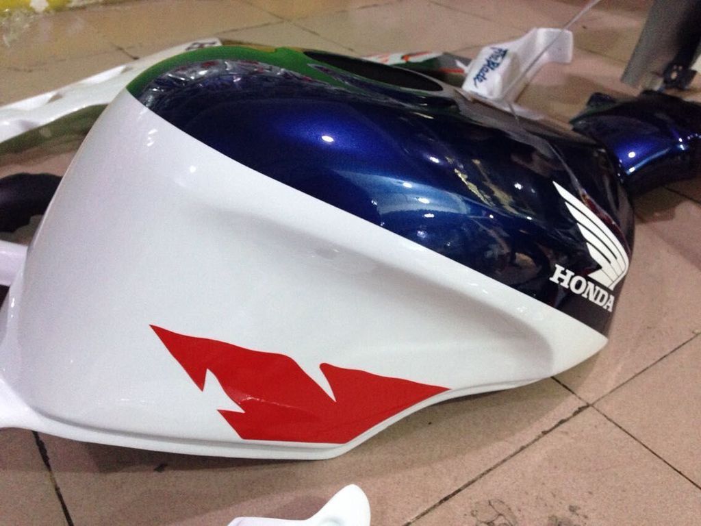

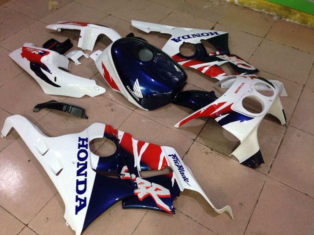

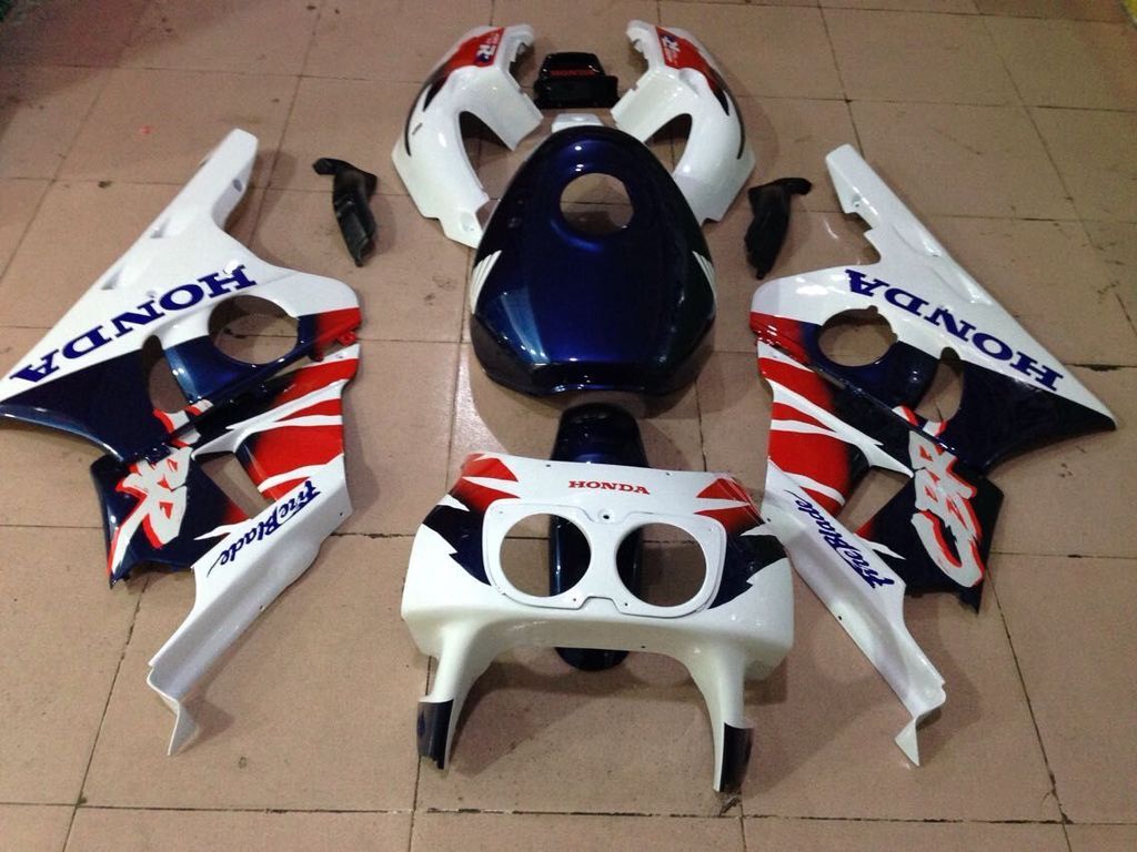

Just received some pictures of my ACTUAL fairing kit which is being supplied by Neverland Motors, I have to say their customer service has been exceptional so far. I have made a few adjustments to this kit to try and get it spot on with the original type 7 and they have been very accommodating and quick to reply. Ill do a proper review on fitment etc when it arrives but so far i'm extremely happy with how it looks. What do you think?..
