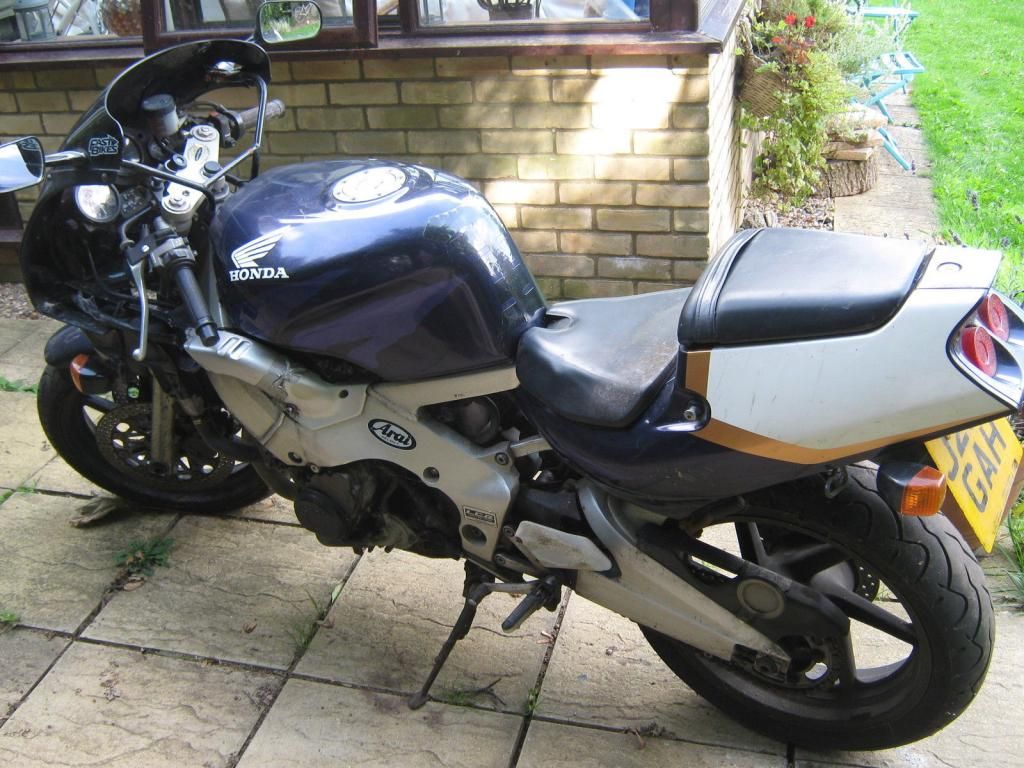

I had a quick look under the CBR section sticky as you suggested but couldnt see any colour options for the paintjob mine has, im guessing its been repainted which is a shame, here is a picture so you can see what im talking about:

I think its modelled after the fireblade anniversary colour scheme as per the below image, Im going to have to drill out the lock to find out what the original paint code is and probably go back to that when I get around to sorting the fairings out.
