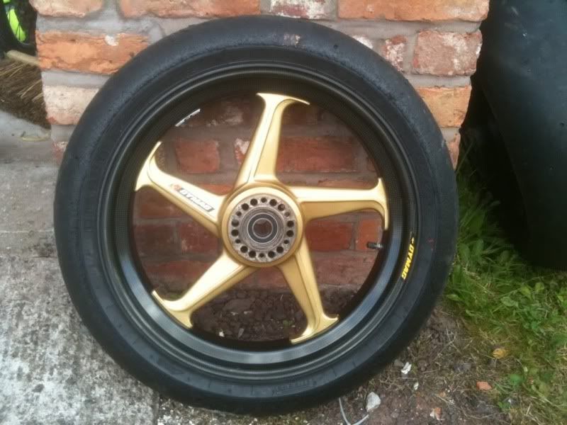

My next bit for it is this
Laminator's got 3 Bimotas (one of them's the 400 FZR engined one)
So get a Bimota
