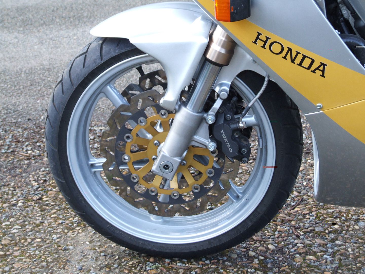

I`ve still got a set of 310mm stealth wavies on the front of my NC30 which I fitted 10 years or more ago -
- they were pretty cheap and have performed very well.
A few years after I bought these Stealth went over more to producing custom/cruiser discs and as far as I can see they are now no longer in business.
Rick
