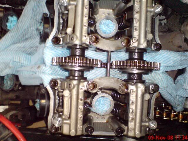

thought i would throw on this useless topic as i am bloody pleased at my losing my valve clearance virginity :D . Plus as some encouragement to any that are a bit scared at doing it.
gotta say, vipers guide is spot on, so i would suggest on following it, still handy to have your haynes beside you (i found it to be a good coffee cup mat
gave myself a whole day(so not rushed - worst you could be), lots of coffee and plenty of metallica and rory gallagher on in the background :D .
its really pretty easy, just time consuming, and a bit fiddly with only 2 shims, the front 2 cylinders outer exhaust valves, but i figured the knack for that
now this was for what will eventually be my track bike/winter hack nc30 and only 3 were within tolerance, if at the wrong end, so after figuring which ones to swap, i am left with 6 to replace.
