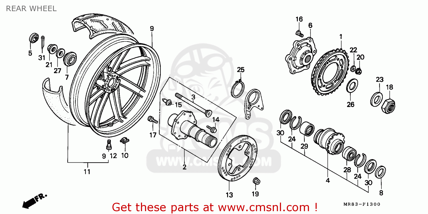

You have parts 26 and 23 the wrong way round, ie the thin washer (26) is on outside of the thick washer (23). The thin washer should be against the hub, inside the thick washer.28hodge wrote:... 999Gomerz im not totally with you? im 99% sure that the rear wheel and hub is put on correctly with the spacers as they should be? ...

Cheers 999Gomerz, i went and had a look with the Haynes next to me and they were the wrong way round, so altered them to be correct before i went on sat.
I also put the 520 non o ring chain and sprockets on and had no clearance issues or tyre/chain rubbing.
