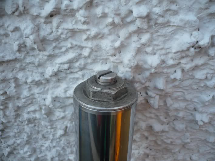

I currently have a set of forks with pre-load and damping.
I got another set which are from a K model.
I know the K model has conventional Damping and the others have a cartridge damper. But will I be able to get pre-load from the K model forks with my tops on them.

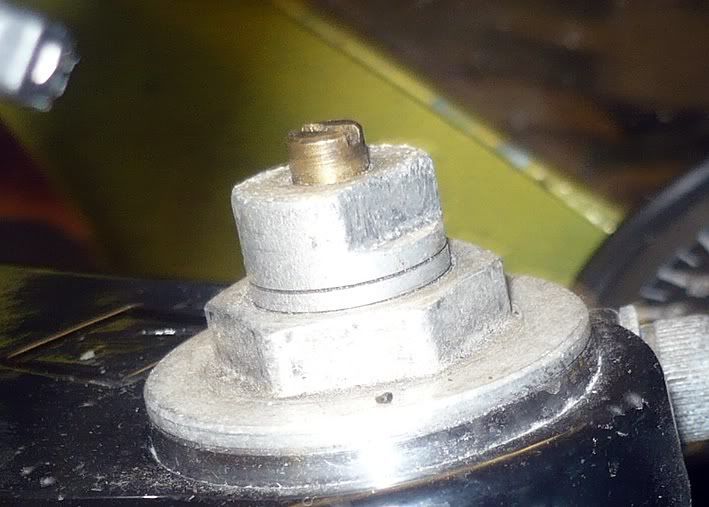

You already have preload on both of those forks. The later models have adjustable rebound on that brass screw.

Always get them mixed up. So if i put my tops on the older forks will I get re-bound or am I going to have to swap internals as well.
Posts: 7152
Re: Front forks
Post by CMSMJ1 » Mon Mar 08, 2010 11:40 am
no, you'll not get rebound adjustment
They are fundamentally different inside. the older ones are a damping rod type and the damping is by holes in the rods as it pulls through the oil.
You can tune this by different oil weight or by having a specialist weld up the holes and create new ones of different sizes. If you felt rich, you could get a cartridge emulator fitted too - never seen one, but assume they meter the oil through shims as per the cartridge in the later setup?
