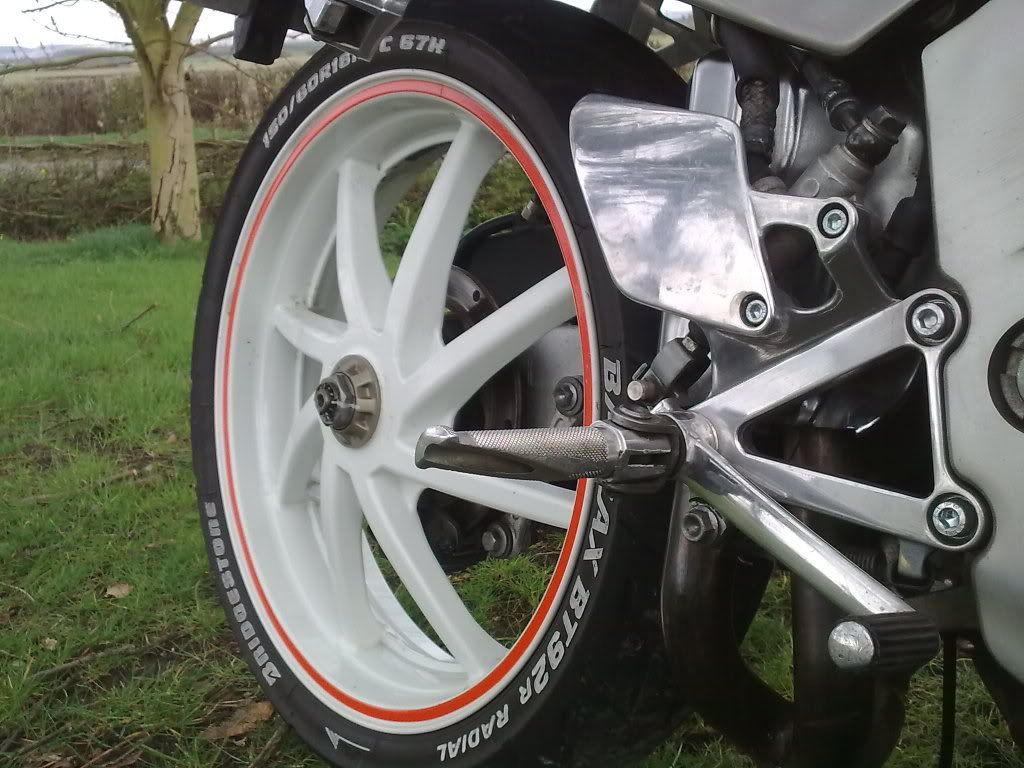

well, i have rang a dyno man and he says that it could be overfueling do to worn needles etc. im not convinced im sure it needs carbs balanced and maybe running lean. But i will try to upload some pictures so that some of u fellow vfr owners can shed some light, what pics should i be uploading?

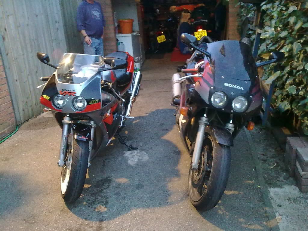

Re: Standard nc30... help needed to get it running better.
this is her.. ill get more pics...
