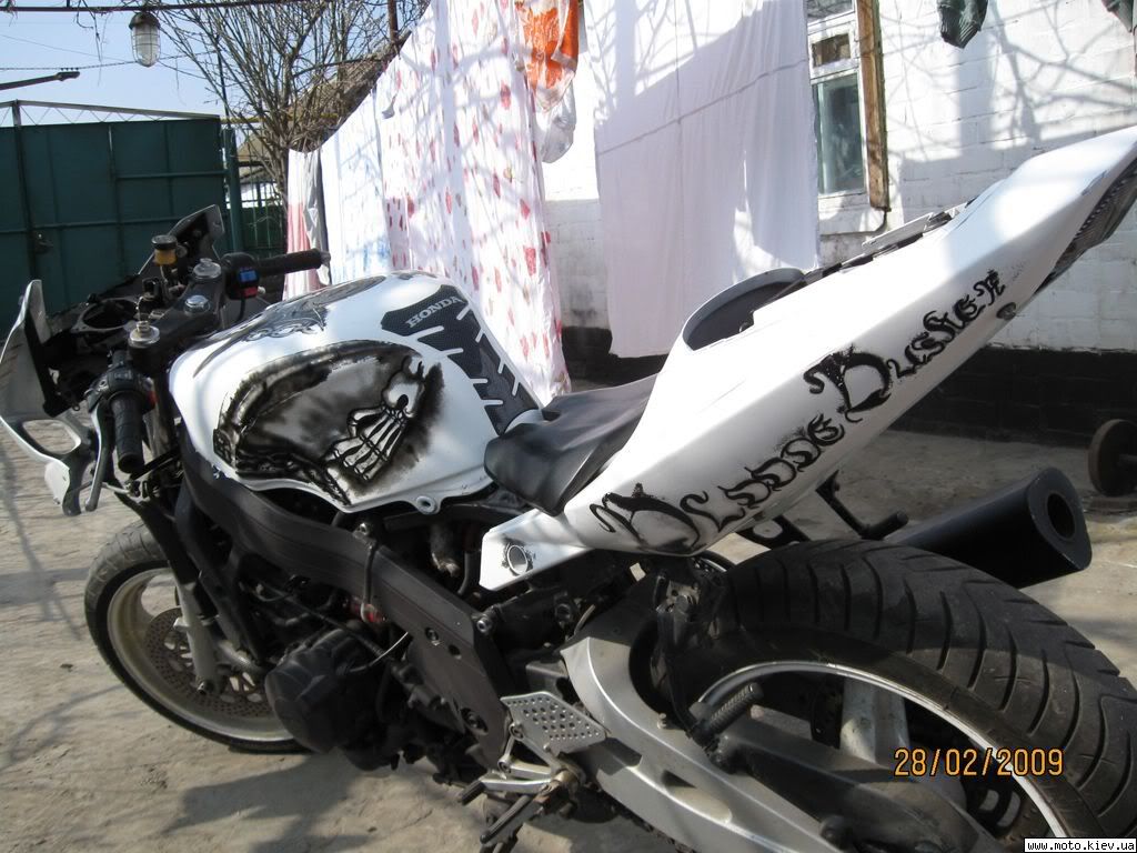

Here is NC23 with CBR600F2 engine. Not any cut for frame
