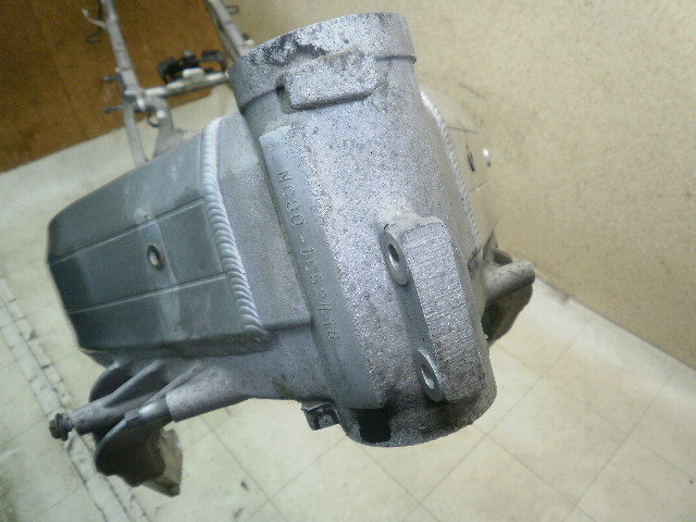

When checking the VIN number on the bike he became concerned that the frame had been replaced. He stated that all Honda motorcycles should have a 'star' stamped at the start and end of the VIN number (mine doesn't) and the background should be 'rough cast' finished where mine is smooth. The frame has been polished on the lower beams with the rest of the head stock 'rough cast'. It shows no damage & rides straight. He stated that its probably had the frame replaced and some time, guessing from the lower spars being polished sometime in the 1990's?

never seen stars on the headstock frame number before...
the headstock is rough cast but the rectangular area that the frame number is stamped into is smooth on all the ones ive ever worked on.
sounds like dealer is either confusing them with another bike or talking out his arse

Hi guys, first of all thanks for the prompt responses. My headstock area looks identical to the one in the photos, so hopefully it's OK. I did wonder if it was rough cast how you would read the number but he seemed to know what he was talking about.

Same here, no stars and just numbers /letters on headstock, nc30 etc etc, he must be confused or he didn't want it and made an excuse, good luck with the sale

...or was trying to get the price down!Barry1234 wrote:Same here, no stars and just numbers /letters on headstock, nc30 etc etc, he must be confused or he didn't want it and made an excuse, good luck with the sale
Maybe he was thinking of this:
http://www.thisoldtractor.com/mg_manual ... cation.pdf
A 'motorcycle identification' guide from 1986....showing for example the VF500 with a star in the VIN
