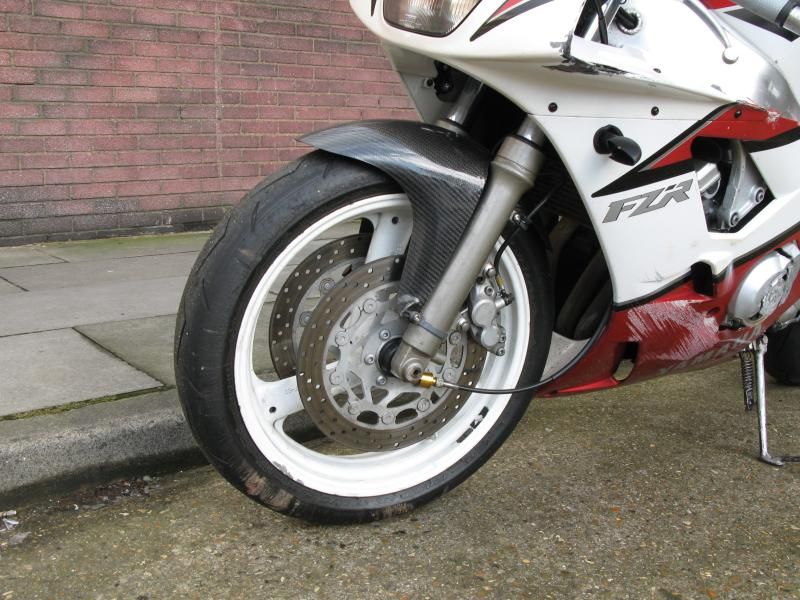

I've used SP forks - they're hard to find though. They bolt in but the mudguard brackets were missing so I used a BDK one. It works very well but I got hit off the bike so I changed it all back before selling it.
