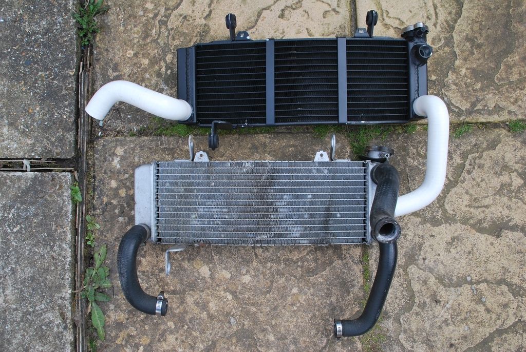

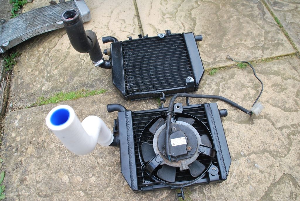

Recently bought a set of Winner racing Radiators to replace my old tired ones on my UK Spec NC30.
Price wasnt bad, think i paid £90 for them, recoated them in black to look more OEM and went about fitting them. Got a set of Winner Racing Hoses from Scott Jelleyman aswel. Hoses are pretty decent.
I understand you get what you pay for, but most Aluminium Radiators these days are all made in China. At 1st, I was that impressed with the radiators at 1st appearance that i sent them my AF1 125 radiator to have it dulipicated. (im restoring one, looks like a mini Nc30)

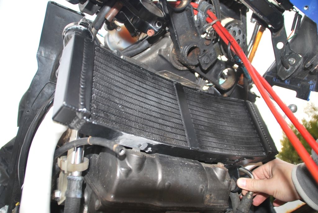

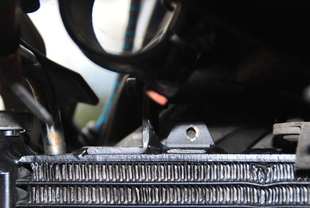

Top Radiator:-

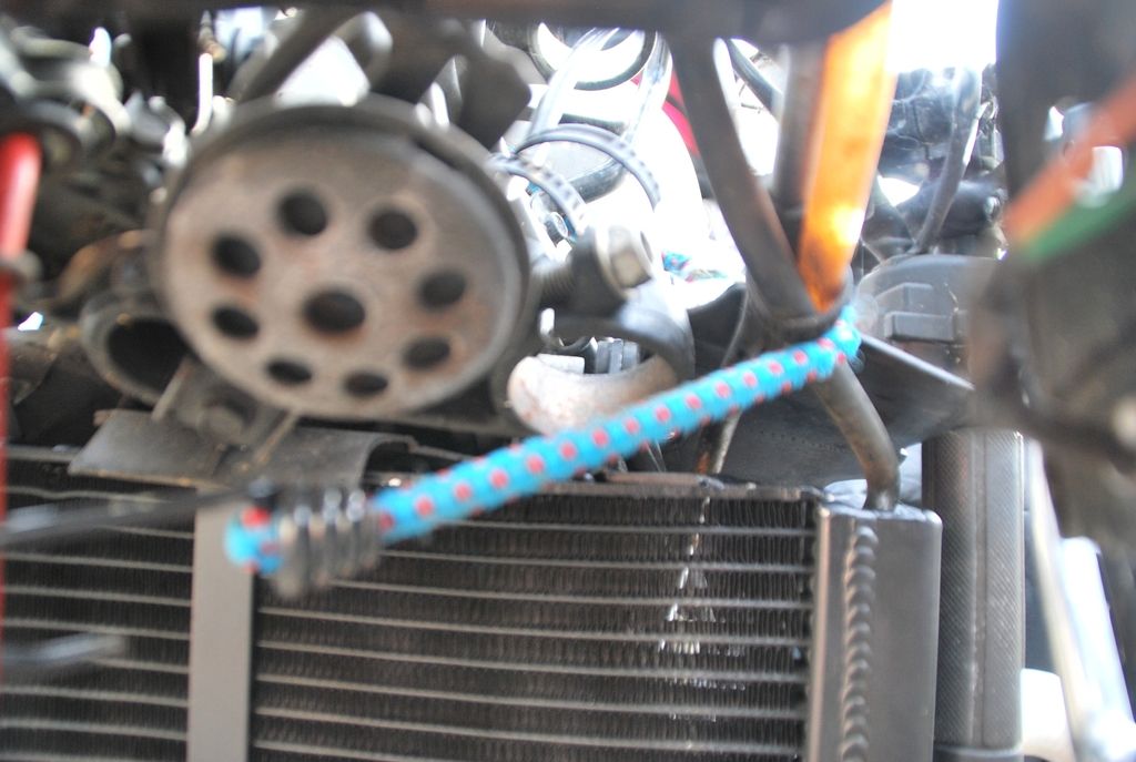

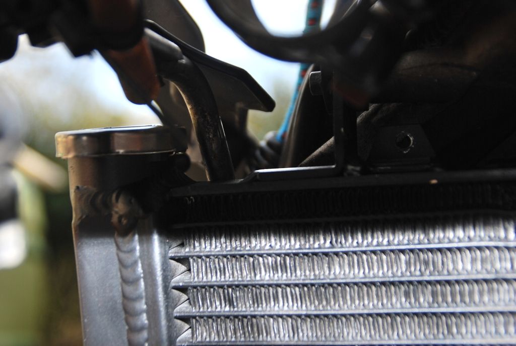

The top radiator fitted terribly, well didnt fit. I used my old rubbers, and aligned the radiator where it must go, but kept fowling on the top of my rocker cover. I bent the radiator grill tabs over, and still wasnt clearing the rocker cover.
Ended up grinding one of them off to get maximum clearance. Just about clears, but still doesnt align with the lower mount at all.

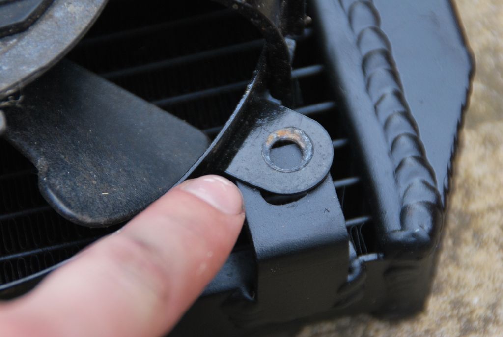

Tried bending the bracket, to bring it in more. Still wouldnt fit the bottom bracket. Top alignment hole lines up,but where you bolt it RH side it about half an inch away.
So overall, fitting has a nightmare. And as its not a track bike cant 'Make do'.
It seems the radiator has been made with a twist in it. Or its just wrong.

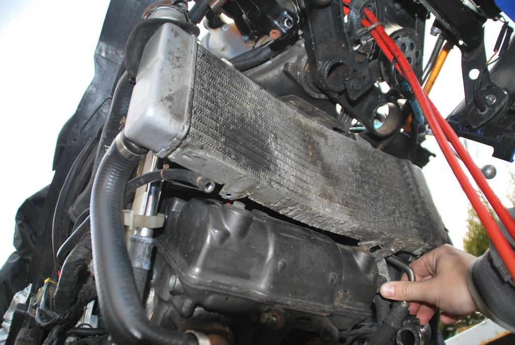

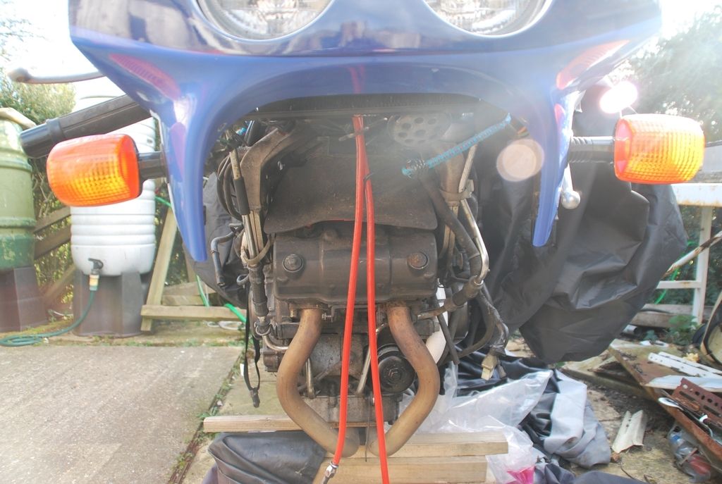

How it should fit (fitted without rubbers)

Havent started fitting this yet, but already can see the fan location is completely out. I mean, how hard is it to jig up 3 holes for a fan to fit???
Have decided to buy another set of aftermarket radiators for now, and fit them. Hopefully might fit better. £60, and will be here Thursday. So can do another review on these.

Top Radiator:-
It clears the Factory fitted Oil cooler fine tho.

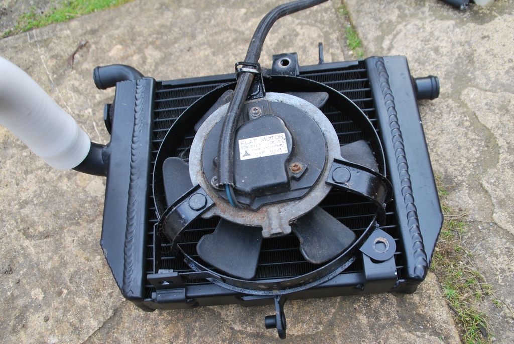

Bottom Radiator:-

Rad fan is 2 mins to move the holes a little, perhaps even just bend the top tap down a little so it reaches both existing holes...surely that's no big deal on something hand made. These rads were like £650 from the uk suppliers originally and then £200 on here with bigger fitting issues and everyone was happy to have to add mounts and adjust them as they were cheap! Now they're £90 and you couldn't even buy the parts in the uk to make them for that now. I do appreciate it's annoying when you want to plug and play but they're so chesp it's unbelievable they can ship them for that price. Bet shipping is £35-40

Hehe, yeh I painted them ages ago. didnt think I was going to get troubles fitting to be honest. They have offered a replacement if i return the old one, and possibly my original one. Still trying to sort something. As they do look quality radiators.pauliealdridge69 wrote:Can't beleive you painted them before fitting

The lower radiator I can easily sort out. Its just annoying having to fettling something, when it should have been done in house. Some people dont have the tools, skills required to modify then.pauliealdridge69 wrote:Rad fan is 2 mins to move the holes a little, perhaps even just bend the top tap down a little so it reaches both existing holes...surely that's no big deal on something hand made. These rads were like £650 from the uk suppliers originally and then £200 on here with bigger fitting issues and everyone was happy to have to add mounts and adjust them as they were cheap! Now they're £90 and you couldn't even buy the parts in the uk to make them for that now. I do appreciate it's annoying when you want to plug and play but they're so chesp it's unbelievable they can ship them for that price. Bet shipping is £35-40
