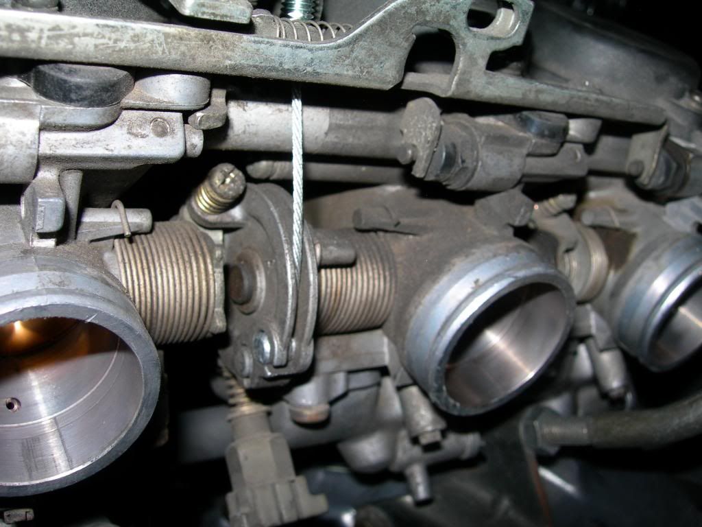

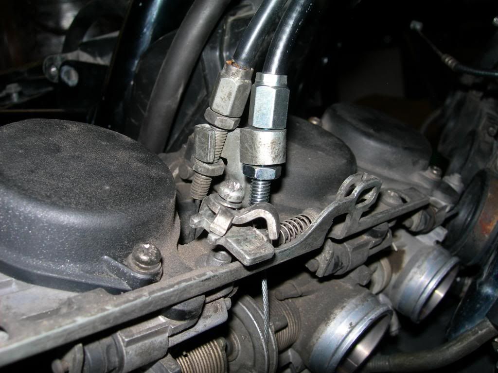

From my experience the most difficult but important thing about sf,is the correct set up of the curbs.So when my throttle cable was broken, about 5 mounths ago,i was looking for a way to fix the cables without remove the carbs and the air box.So i managed to do that with these tools.It took me about 2 hours.
The only thing i have remove was the gas tank.I was working from the right side and under the carbs (as we seat on the sf).You must be patient because it is delicate work.the goal is to move the small cylinder edge of the cable, in this cylindrical base between the curbs.Το do that you have to pass the cables from the right point (as it was before remove them).
And remember as we see the curbs,front=reset throttle cable,rear=opening throttle cable.
So as you can understand in this picture you see in the foreground the opening cable and behind the Reset cable.
PS:The reset cable is the hardest purt.I hope I helped .

Can I just check this with you, do you mean in the picture the foreground is the reset cable and the rear is the opening cable?tomigun wrote:And remember as we see the curbs,front=reset throttle cable,rear=opening throttle cable.

Let's go again,red arrow=openning throttle cable,yellow arrow=reset throttlecable.This is the airbox side of the carbs.
