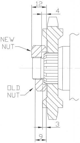

ADDITION; if you get a renthal front sprocket you would be advised to get a spare lockwasher.
Sometimes Renthal use a sprocket that fits both Kawasaki and Yamaha output shafts...the Kwak spec is fractionally thinner and is a tad loose on the shaft when nut is tensioned.
Use the spare washer behind the sprocket.
Also; 600 fzrs are noted for the retaining nut coming losse a buggering the shaft threads.
Upgrade to an r6 nut...it has marginally more threads.
