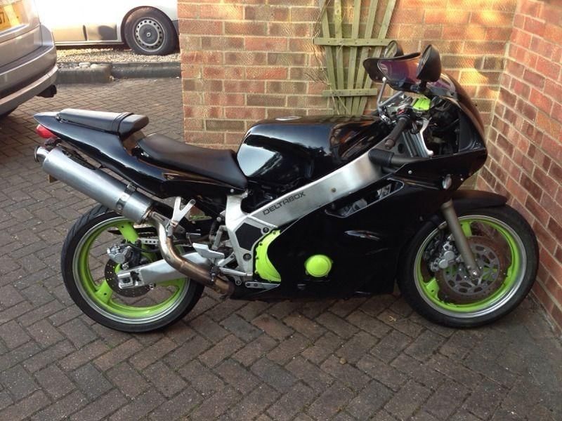

This is what it used to look like but now its rather shonky looking
The R6 rear seat and fairing is stuck on some square box frame that looks terrible so that will be going I will be on the lookout for a rear 3EN2 subframe at some point and proper seat plastics / seat

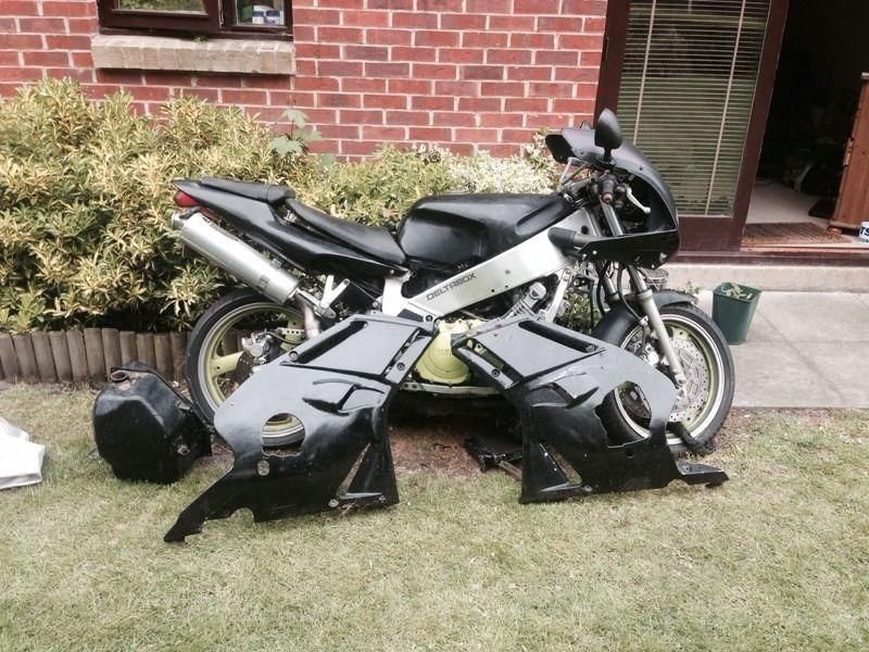

Even this picture makes it look alot better than it is, this weekend I will be mostly getting it going, fingers crossed the engine is good.
