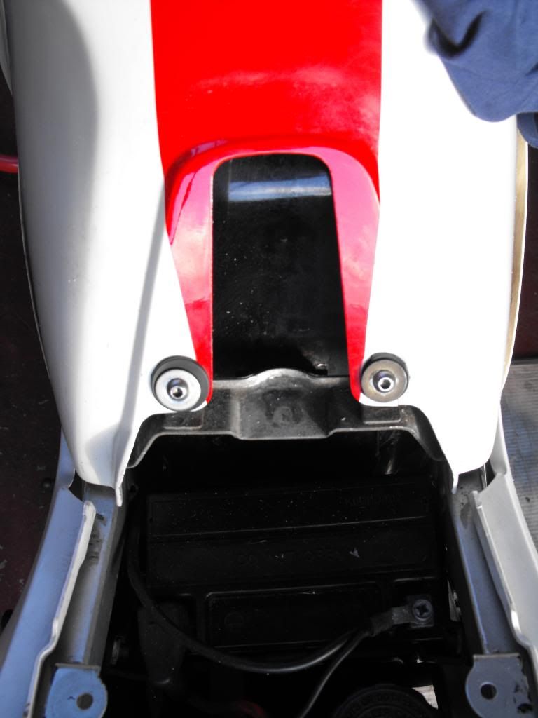

Won't suit a 3EN2...the seat won't cover the massive gap at the back of the tank cover.

This is the gap on a 3HE cover;
It was more in reference to the seller in the ad. shitting up the benefits of plastic over metal.
I did not know until just reading this topic that 3EN1 covers were steel.
