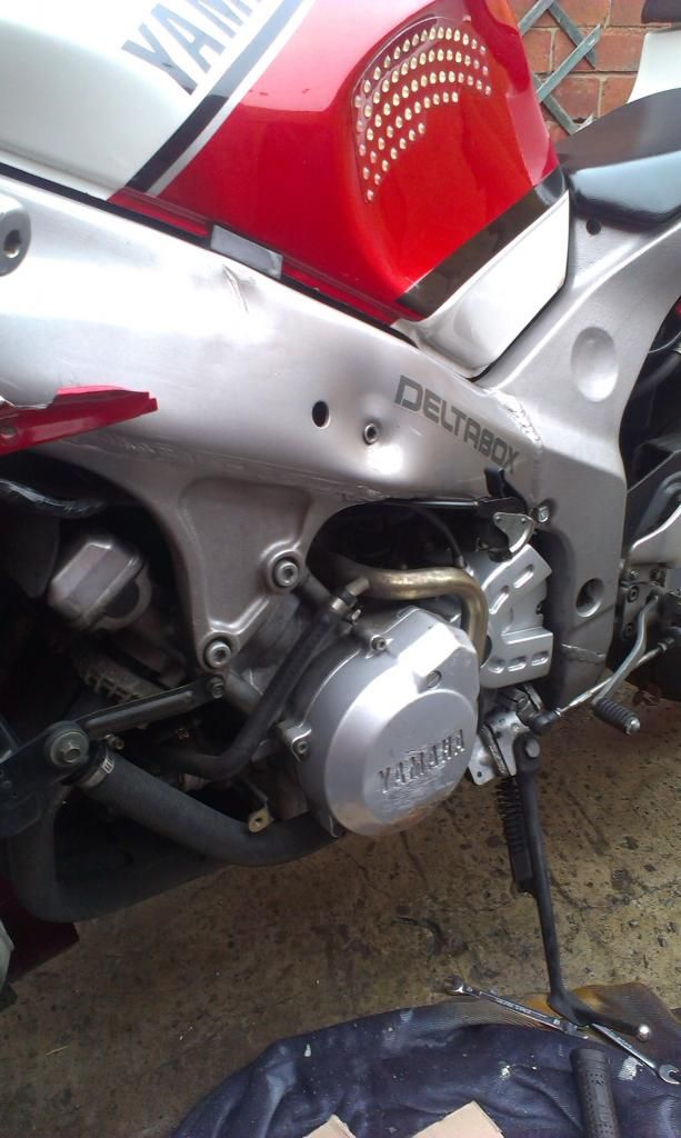

6. This ones a not really a problem but it's bugging me! After dropping my bike last year, I've got a nice dent in my frame, Is there anything that can be done about it or should i just deal with it?

To start with the last thing first - that's quite a ding !!! Not sure if it can be pulled out (around the fairing mount) it would need to be a specialist thing it though and you'd need to fill any imperfections and the dent from the bar higher up. Filling a frame isn't something I'd want to do ... and I wouldn't want to find it either.
That was a write off huh ?

The dent came from a slow speed drop while braking, No insurance companies were involved so not a write off only thing damaged other than that was the genny casing but that was easily replaced. The dent was caused by a crash bung that was fitted by the previous owner. Clearly in the wrong place! I feared it may be a specialist job so i guess i'll just have to live with it unless i strip it down again and send the frame off somewhere. More hassle than it's worth really.

Try a body shop for the frame, they might be able to use some heat and a slide hammer on it.
Crash bungs are usually more trouble than they're worth.
