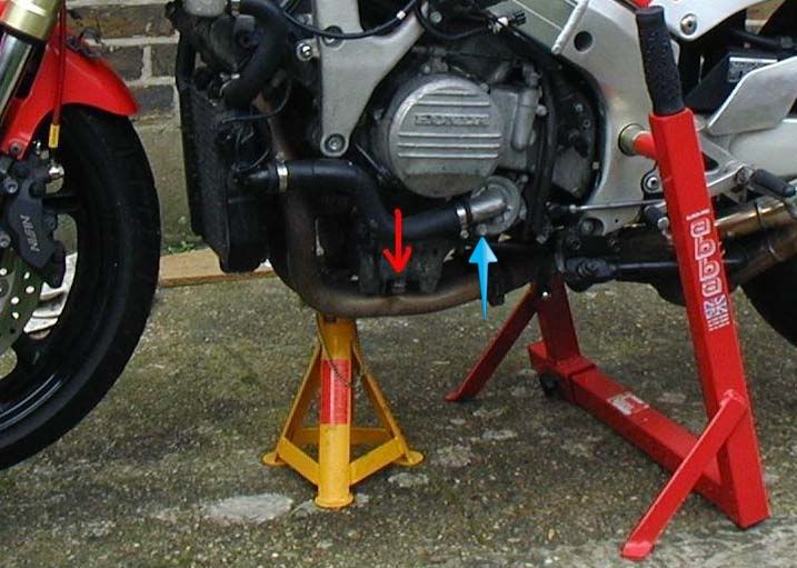

- Speedy
- Posts: 483
- Bike owned: RVF400RR, ER6n
- Location: Middx, U.K.
Re: Bike dripping water from (overflow?)tube when turned off
Remove the rad cap, then drain the coolant by removing the water pump bolt (blue arrow on pic).
Coolant will shoot out, so be ready to catch it.
Flush the system with water by inserting a garden hose on the rad cap filler neck.
Re-insert the water pump bolt & seal and refill the system with coolant; bleed the system of any air before re-installing the rad cap, by blipping the throttle a few times. Refill the coolant reservoir to the correct level.
Thanks guys, I feel like an idiot as I was looking on the wrong side for the water pump. The Haynes manual seemed to be saying it was on the right but maybe they meant facing the bike. Will flush the system and order a new rad cap hopefully sorts it out.
