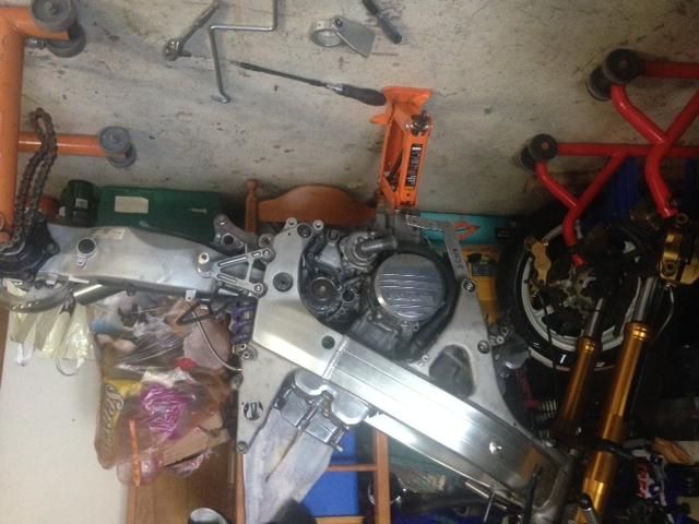

So i have started to build an NC35 race bike.
(I also have a nice trick NC30 bike for the road to get "bike fit" as i dont get to go to track as often as i would like)
I had a few bits left over from my last 35 race bike so decided to start afreash and build one from scratch.

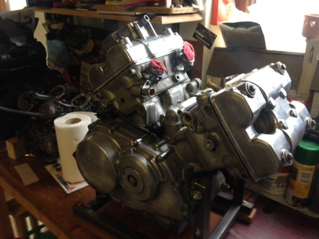

The engine is from a guy i met at Pembrey - this was a spare race engine he had for his bike it has done around 10k miles and has the following,
Runs total loss
Quietning gears removed
Shims done
Oil pressure valve removed
I plan on tuning the heads over the winter once i have made sure the engine is good.
Frame/suspension
NC35 frame
Triumph 675 maxton worked forks
Maxton fully adjustable rear shock
675 radial calipers
vfr750 rear wheel conversion
I have a MHP twinstack that i plan to use, or i have a mild steel 3/4 HRC copy exhaust too. But it depends on the power output as to which i use. I need to be under 64bhp for Bemsee.
I am going to spend next season getting the bike right for me, and will probably get a race subframe and some other nice bits once i have decided whats the most important.

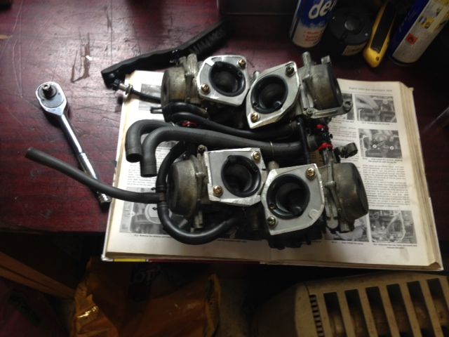

NC30 carbs with HRC kit, and HRC slides (rounded bottom and twin hole)
Runs total loss
Shims done
Frame/suspension
NC35 frame
675 radial calipers

Looking good mate, hopefully next season I will be out for a few rounds with bemsee too now the bike is actually ready. Quick one about the HRC carbs, do you find it hard to fit them with the top plate cut away like that? And does it give much of an advantage over just drilling it as per the HRC manual?

Cheers guys,
Yes they may be a bit tricky to fit, but i have used the 35 carb rubbers as they make it easier to get the carbs on.
I also have a spare top plate so will use this as a sort of die to help get them on. I normally use a small smear of 2t oil on the rubbers too to aid slippage
