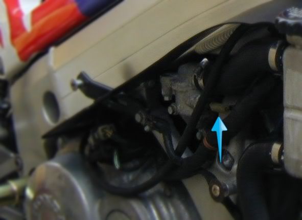

As you found out, the wire you grounded is for the fan; at least now you know the fan still working.dogmatic69 wrote:...ground is ground so not sure what difference any other ground would make...
And when I say I "grounded it", that would be referring to the single temp sender wire normally connected to the sensor on the left rad
As explained by others, ground the single sender wire (yellow if I'm not mistaken) which you can find attached to the thermostat on the right hand side, mid panel.
This pic should help:
If the needle moves, the problem might be the sender itself.

- speedy231278
- Posts: 1549
Re: Temp needle never moves
Yup, that's what I meant! Sorry if it was unclear!Speedy wrote:As you found out, the wire you grounded is for the fan; at least now you know the fan still working.dogmatic69 wrote:...ground is ground so not sure what difference any other ground would make...
And when I say I "grounded it", that would be referring to the single temp sender wire normally connected to the sensor on the left rad![]()
This pic should help:![]()
