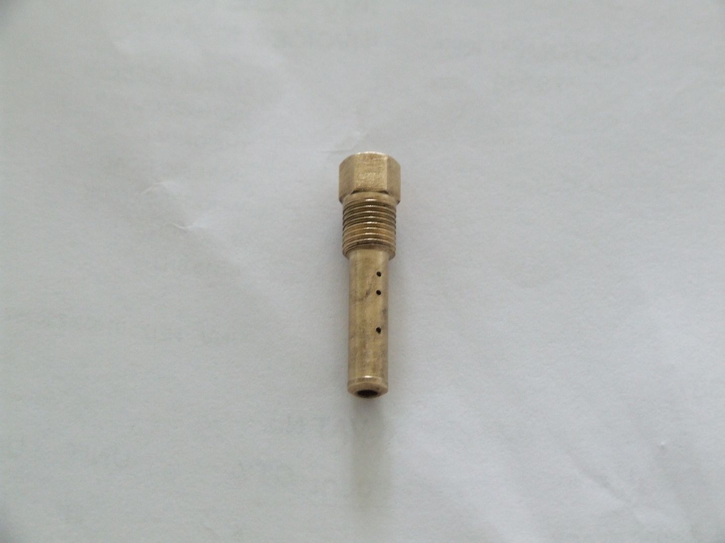

Will a photo of the whole carb set help you? or you need to see tubes mounting points?

I need somebody who has a set of NC35 carbs off the bike to open the front and rear float bowls, take out the emulsion tubes and tell or show me which type is fitted to the front carbs and which type to the rear carbs.

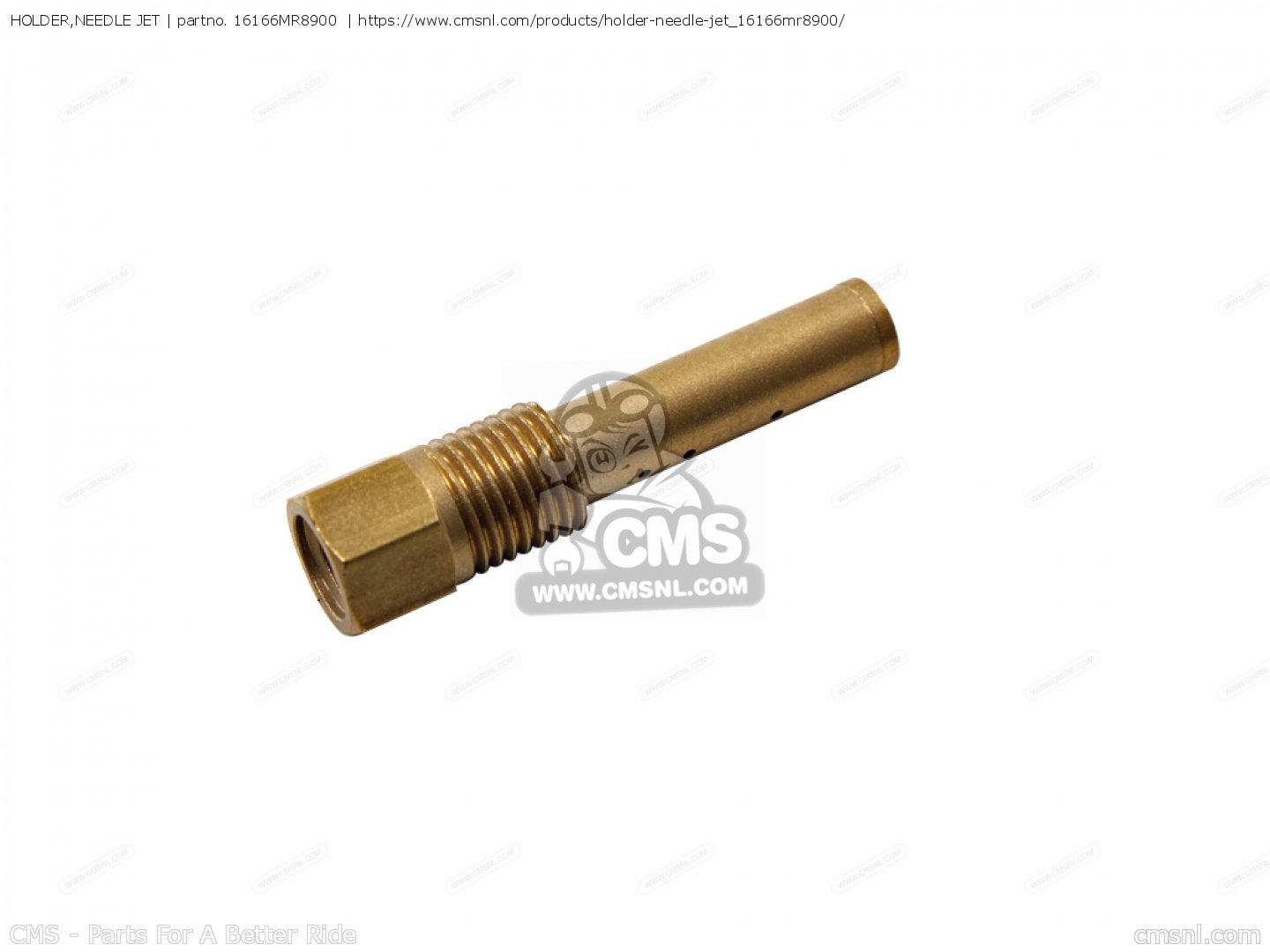

Can it be trusted that a second hand set of carbs has the emulsion tubes in the right place?
You can still buy the emulsion tubes new (at least the rear ones anway).. one of which should be enough to determine what goes where?
not sure if its a generic image or a proper image but cmsnl list this as the rear emulsion tube for the 35 if its of any help, maybe combined with some peoples reports
- speedy231278
- Posts: 1549
Re: NC35 CARBS - INFORMATION PLEASE
According to the pics on CMS' website, the tubes with the wider spacing are the fronts. The hole patterns are different in the pics for the front and rear tubes.
