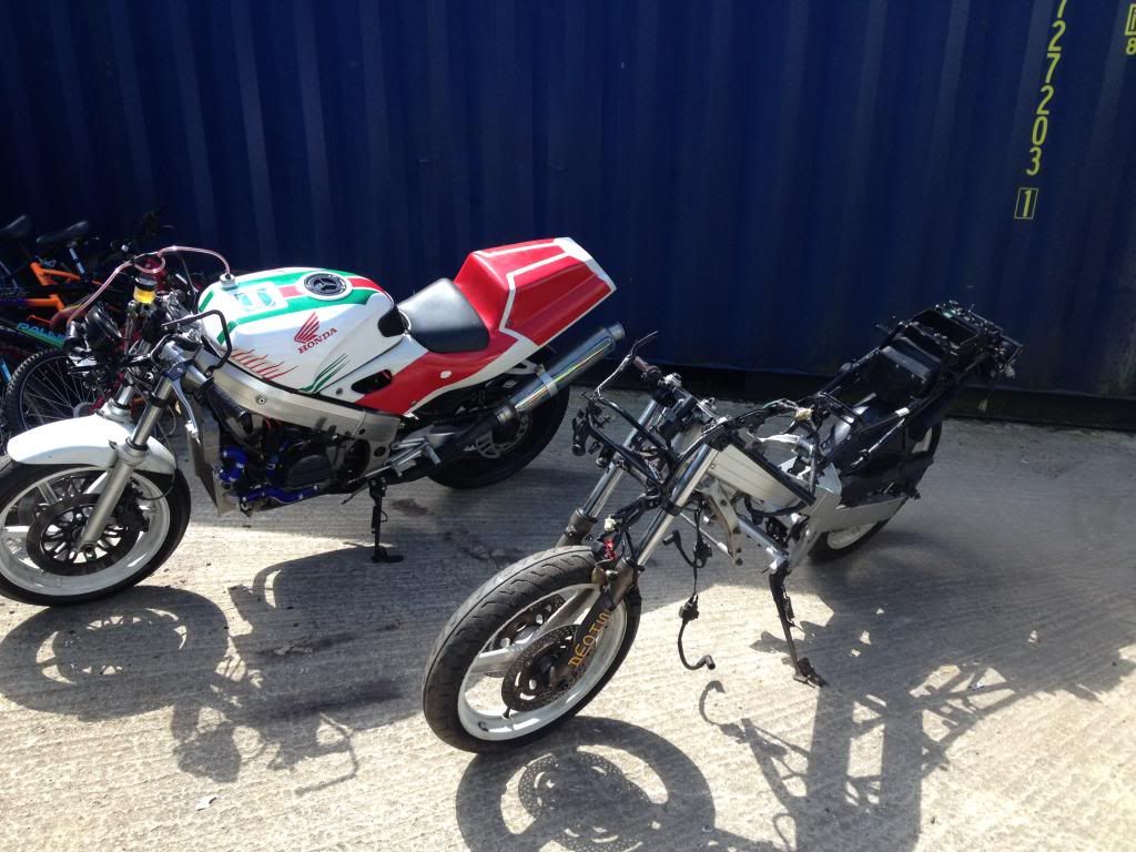

Anyway on to the photo's this is how the bike looked before being stripped down by the guy i bought it off.
It was stripped down a bit more than this when i bought it si i have refitted the subframe, undertray, loom and clock mount.
The NSR is tiny compared to my NC30, will be interesting to ride im sure.
