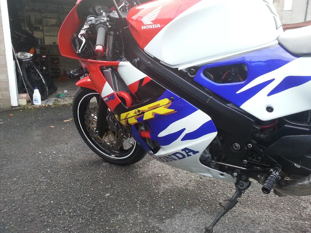

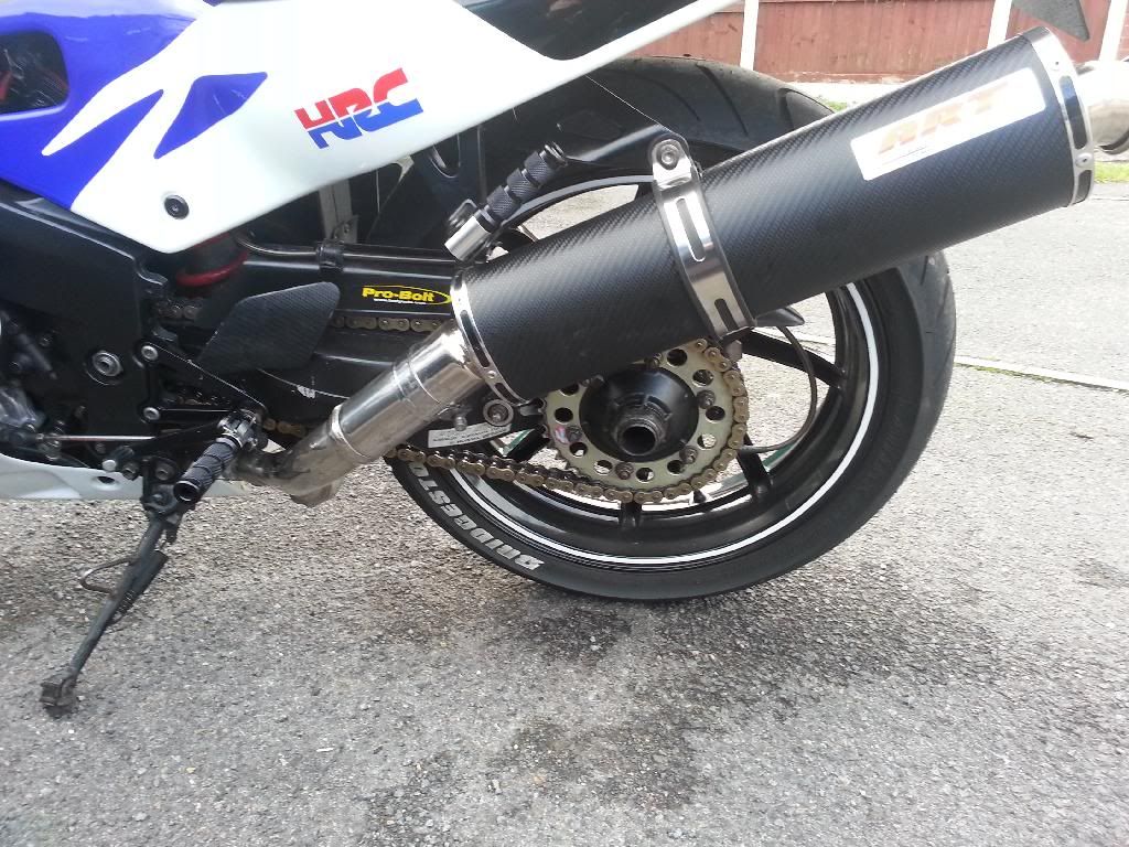

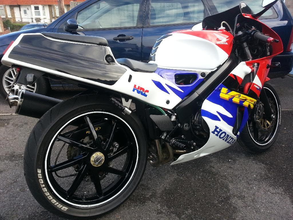

Hi guys, been a lurker here for a while but now I need your help....pretty please!
Anyway, I'll introduce myself. I'm Mitch from down in sunny Kent. Bought my NC30 last August and have only ridden it a few miles. Maybe 30 at most. Here is pics for you all.
I have owned 2 NC30's before but usually I pay a garage to do the work. I am a lot more patient than my younger days so I've decided to have a bash at maintaining/fixing this one myself.
I have pulled it from the garage today after booking a track day for April 12th. The bike has to be running well by then or I'm going to be gutted. I knew the bike had been running quite rough and today found that the front right cylinder header is only getting warm unlike the rest which are scolding hot. On initial fire up it heats up quite quickly but then levels off at a temp I can just about touch.
I have swapped the plug from the misfiring cylinder to another but the problem still persists on the same cylinder. I have a receipt for new plugs from a month before i purchased the bike. I tested resistance on the coils. Rears were 4.1 ohms primary and 24.15 ohms secondary. Fronts were identical.
Pulse generator coil gave me 428 ohms.
Both front plugs had a small amount of oil at the tops of the threads. Not sure if this is normal.
There is a flat spot when riding between about 8-10,000rpm which may be related. The bike feels very down on power from my previous NC30's.
I found that the ignition lights were only coming on intermittently when turning on the ignition. On further investigation I found some very bad solder joints on the back of the switch so a new replacement has been ordered.
What is your advice on my next step guys? Any help is greatly appreciated.
Mitch.

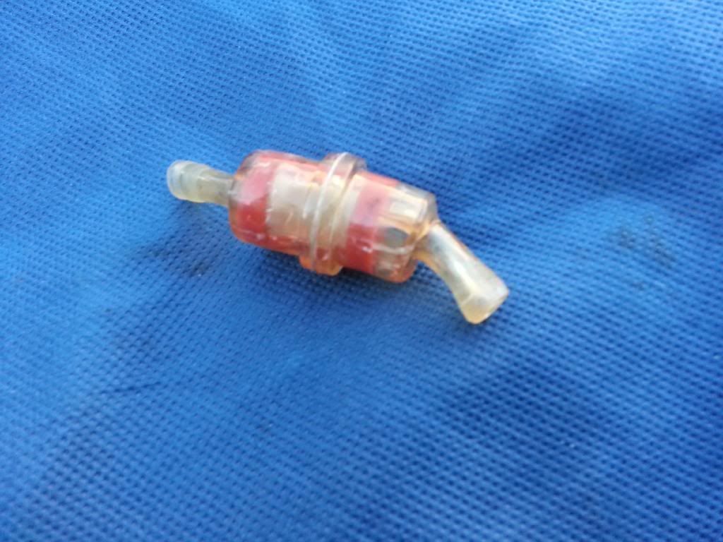

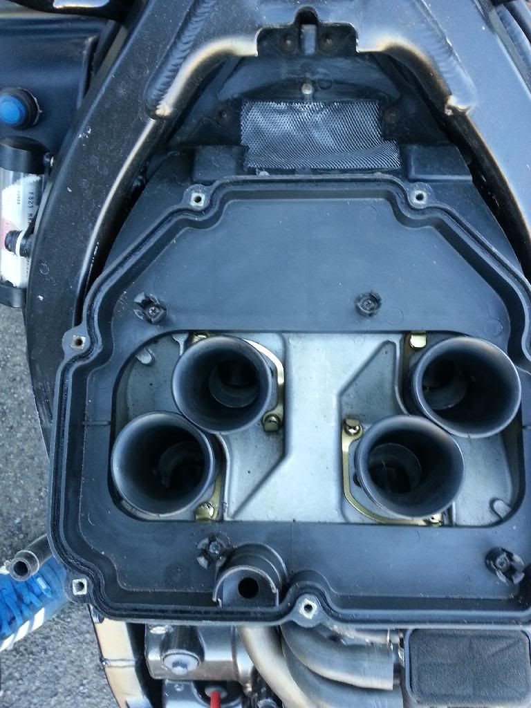

Any ideas anyone. I now have the carbs off and planning to check the settings and clean them tomorrow. The fuel filter looked like it had began to melt when I removed it! The airbox has had some mod done. Could this be causing the flat spot? Shall I return it to standard? Pics of filter and airbox below. Thanks.

I think your fuel filter has 'reached the end of it's useful life' if I'm being honest!
As for your airbox, there's a flappy rubber part that sits near the mouth but I can't really see what's going on with your pic. They need this as I'm sure you know having had '30s before, they're very sensitive and funny about even small changes to their breathing and fuelling. This might explain your 8-10k rpm issue. Mine pulls really strong from 9 up to 13k. It will happily bang into the limiter but is best in that range.

With regards to airbox, if you look at the top of the picture you can just make out a gauze that has been stuck over a hole that has been cut out of the plastic. I'm sure this is a common mod as my old one had the same mod but was set up professionally. Im pretty sure this bike has had a DIY job so I may just return it to stock and follow the jetting guide on here.

That fuel filter is probably part of your problem.
It is not needed.
As the NC30 uses a gravity fed fuel system (and already has a filter in the tank and each carb) adding an inline filter can seriously slow down the flow.

bikemonkey wrote:That fuel filter is probably part of your problem.
It is not needed.
As for it being one cylinder that's the problem, I'd be investigating that cylinders carb, and all the others whilst I was at it.
Thanks. Definitely going to bin the filter. If I get time today I'll have a look at the carbs. Do I need a gasket set or can I reuse the gaskets?

:plus: for getting rid of the inline filter. Not needed and only going to cause problems rather than solve anything and go back to OEM on the air filter / flow set up.
