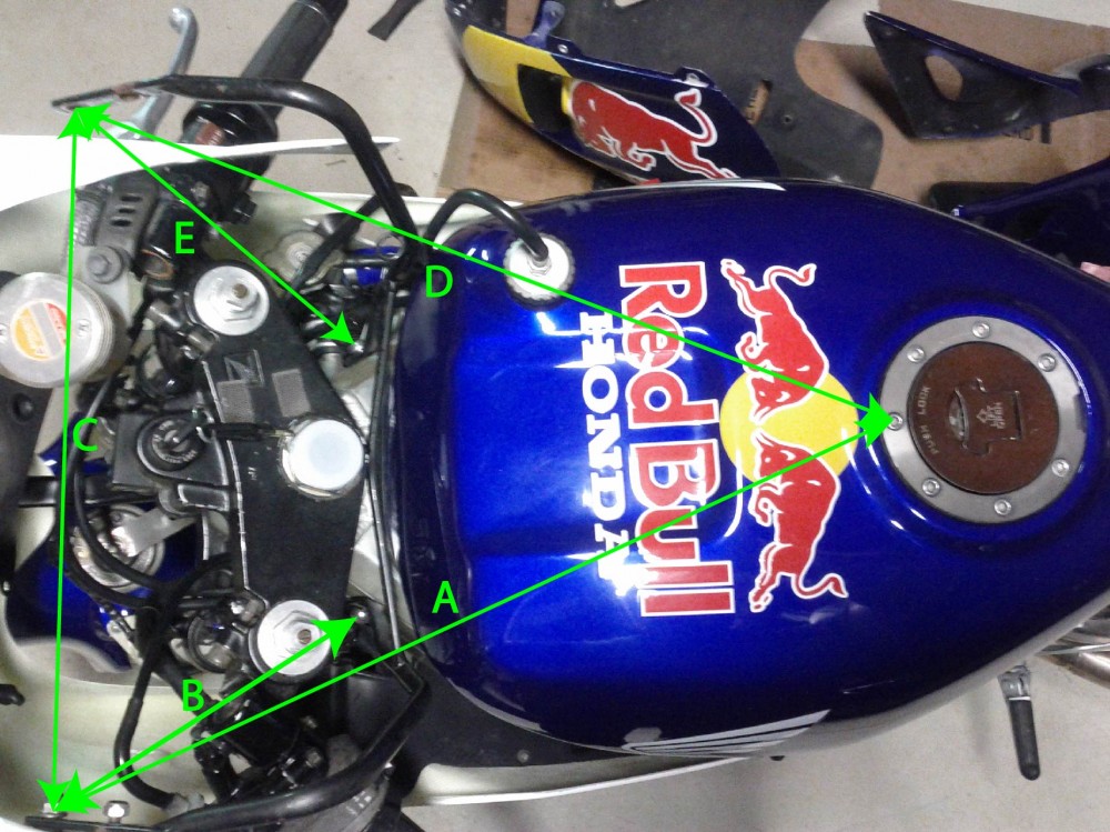

I'm trying to get my Tyga fairing to fit and having a hard time with the mirror stays. They are obviously bent, and I don't really know how what the shape is supposed to be. If anyone with an unmolested upper fairing could take some measurements for me, that would be awesome:
If I can get the distances in the figure above, I'll be able to figure out the shape:
A: From the front tank lid bolt to the front bolt for the left side mirror
B: From the mirror stay left attachment bolt to the front bolt for the left mirror
C: Between the front bolts for the left and right mirrors
D: Like A but on the right side (I assume it's supposed to be equal to A)
E: Like B but on the right side (I assume this is also supposed to be equal to B)
Things can be bent in so many ways that it's super difficult to get it right just by looking. I'd massively appreciate if someone could take the time to do this!
cheers,
/Patrik
cheers,
/Patrik

I'm no expert on Tyga fairings, but to my knowledge (I'll be corrected if I'm wrong) the Tyga upper uses a different brace/stay...
I'm fairly certain the brace in your picture is standard honda fitment, hence the failure lining it up

Tyga has several different fairings. Some don't use the stock brace, but the one in the picture is (supposed to be) a direct stock replacement.tomski wrote:I'm no expert on Tyga fairings, but to my knowledge (I'll be corrected if I'm wrong) the Tyga upper uses a different brace/stay...
