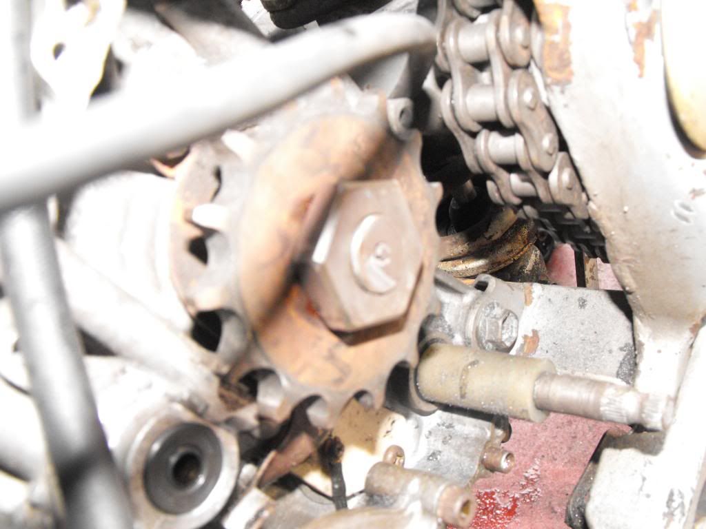

Yeah, it's an absolute pile of cack. We found the front sprocket nut welded on this afternoon. Chris did this-Morespeedvicar wrote:Bargin that kayla, cant believe that anybody thinks the black 'streetfighter' fzr looks good! Why would you do that to a bike. Each to there own i suppose.
Ian
and I can't blame him
Still, it's not insurmountable. Silver lining and all that, what.

Them 3he's have a nasty habit of that being done to them !
Fixable though;
Use a thread file and replace the std. nut with;
YA 09891-10124-00.
Thicker,harder and more substantial,from an R1/6, I believe.
Fixable though;
YA 09891-10124-00.

No excuse for that though, it has a tab washer ffs

Seems quite a common fault judging by the numbers on the forums.
On this particular one,the P.O.had fitted an incorrect sprocket which spat the nut loose prior to the welding fiasco.

Normally when I see that it's not due to the nut coming loose, it's due to the splines on the output shaft being worn to the point that the sprocket HAS to be welded to transfer any power.Evilchicken0 wrote:No excuse for that though, it has a tab washer ffs
