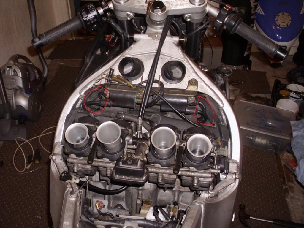

Here is a pic of my nc29, i have circled the ht leads in red, they go to the front to spark plugs, you need airbox off to get them out, just wrap them and see how it goes mate
